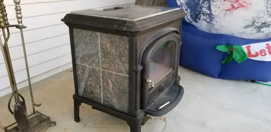

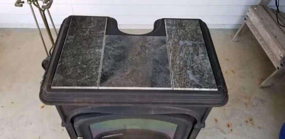

Hey everyone, I’ve been reading a ton on here for a month or so trying to decide what to go with for replacing my fireplace (very helpful thank you!). I finally decided on a wood stove and am pretty sure I want to get a hearthstone. I was originally thinking shelburne but after seeing a Phoenix in store I’m considering that. In store it’s $2500 new; I found a used one around 3 hours drive away. I spoke to the gentleman who owns it this morning who said it was used for 18 years (bought new in 2010) and was perfectly fine when they switched to pellet last year. Since then it’s sat on his porch under a tarp. He said he’s negotiable on price. It Has some minor surface rust which I believe I could touch up so that’s not my concern. He said it was all in working order sealed well and glass was good when last used. It’s very tempting to go for but is it worth it to get a stove that’s almost 20 years old? And if so is there certain parts I’d want to replace before install. Also if it’s worth it what price should I be looking to get it for? I’ll attach the photos he sent.

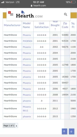

Webby- I’m not really sure what you mean about hearthstone stoves. I’ve ready nearly no negative reviews on here about them. Maybe you could elaborate with some helpful information?
Go to stove reviews section and search hearthstone.
Again, I don’t really see what I’m missing here? I wasn’t asking for a review of the stove. I was asking for an opinion on if it’s worth the cost savings to buy a stove that’s 19 years old or if I should just go new. If old is just as good as new then I’ll go for it I just want to know what cons there could be to buying a used stove. Do they have a max life? Would it be worth it to rebuild/what would that cost? Or should I only fix what is broken? What price should I try to get it for?Or just buy the new one? I’ve seen a lot of great discussion on other similar posts; I couldn’t find one that related closely enough to this stove/years of use so I asked.

I bought new a hearthstone heritage made in 2007. The same era as that phoenix and a very similar stove. The phoenix used a lot of the same parts. The phoenix was a nice looking stove, especially in enamel. I almost got it instead.
I used my hearthstone for about 6 years and put about 30 cords through it. The stove looked good and performed as it was supposed to by getting overnight burns and keeping my home warm. Glass stayed clean and the fireshow was great. That's the good.
I dumped it because the hinges and door latches wore out very fast and replacing them meant a total stove rebuild. The tiny little hard hinge pins hogged out huge holes in the soft metal hinge pin holes of the stove body. The door latch rubbed off cast iron from the non-replaceable door frame to a razor thin latch that could break off at any second. These stoves are not made to last. It is not made to be a sole source of heat for a reasonable amount of time.
Then it was ridiculously inefficient. Clean burning since it puked tons of heat up the flue. Soapstone is pretty but actually a terrible material for a woodstove. Sure it stays warm after the fire goes out but it also takes hours of high burning to heat up and begin making heat. If you keep it hot then this is fine, which is why long burn time stoves with cats are more suitable to be made of stone.
My stones did not crack. I was very careful to keep temperatures safe and not throw wood in. I'm a woodstove enthusiast, many of these stone stoves have been abused and will have cracked stones and melted inards because the operator wasn't patient enough to wait around and just left the thing on high.
So no, unless you want to just look at it, I would not recommend a hearthstone stove from the 2000s. Either because the previous operator wore it out or because you will wear it out quickly.

If you're going to buy either an old or a new hearthstone then whether the old one is worth it depends on the condition of the stove and the price. Some new Hearthstone models have beefed up hinges and latch systems so you could actually be getting a better product in addition to something that is not worn out.
After owning stoves with substantial, strong, durable hinges and latches I can really feel how chincy and decorative those hearthstone stoves were. Be sure to look at other brands.

Did the fellow say how much wood they burned a year in the stove? Why are they selling?

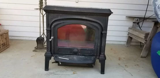

Sounds like the old owner switched to a pellet stove. This phoenix was moved outside and sat out on the deck for a long time under a tarp rusting.

Yeah I was thinking he seems like a good guy to deal with too. I’d like to take it off his hands. I am sad to hear about the reliability issues this is the first I’ve really read about the negatives. Mostly everything I saw was about the consistent moderate heat (less fluctuation) and long burn times.

For me the 8 years of use are nothing compared to the year sitting outside. I wouldn't pay more that $150 to $200. If that
I missed the part about it being outside under a tarp. That would be a deal breaker for me.
