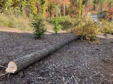

So we had 2 trees taken down. They dropped them and we are cutting them up. One tree was a hickory and the other an oak. We have worked with oak before and it was never a problem. We worked on the hickory today to get it cut into rounds. Wow is that stuff hard. It tore up a brand new chain after cutting 1 round. The chain saw would start smoking before we even got through the round. It took us forever to only do a few sections of the tree. Our son sharpened one of our older chains and that did a little bit better than the brand new chain but we called it quits after a while and will probably have to sharpen the chain at least 2 more times to get the entire tree done.

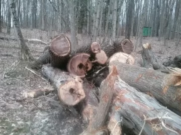

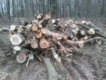

Something seems amiss, I cut all this mostly hickory with only two chains, yes sparks were flying but no problems. are you sure you were getting oil to the sawblade? Good luck. Some rounds were three feet.
[Hearth.com] Wow! Hickory! [Hearth.com] Wow! Hickory! [Hearth.com] Wow! Hickory!
Nothing should be "smoking" while running your saw if things are correct. Double check your bar oiling and chain sharpness. I have cut plenty of hickory and even harder osage. Sparks? Yes. Smoking? No.

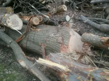

The professional taking the tree down had issues as well so it wasn't just us. I do not know what type of hickory it is. It's not shagbark. It's also not a huge diameter tree. Not looking forward to splitting this stuff.
That looks like pignut . Good firewood !
