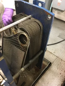

Cleaning up the plates for my DHW heat exchanger.

That is one heck of a HX. Do you have to clean it occasionally? I've been told that oversizing a plate HX can drop the channel velocities and the tend to lime up more frequently??

I have to come clean guys .. I pulled a 14 hour Gyrd shift at work last night . That HX is a cooler for Cat 3512b. It was the annual cleaning, the cooling media is sea water, they get plugged up pretty good with sea weed ,slime etc. I've cleaned dozens of them over the years . And yes Kelster we use CLR and pressure washer, they don't work to well if you get the plates mixed up. A little frigid up where you are -22c.
