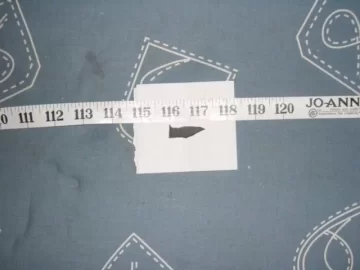

can you believe its a pice of rubber i wonder how bad thid would have screwed up my pellet stove!!!

well i looked in my stove(hopper) and there it was couldn't believe but the last bag i poured in was NE wood pellet the bag before that was future fuel
butit was right at the top so i believe it was ne wood pellet

what if it got caught in the auger?

eh...1-1/4" would likely go right thru the auger. I can tell you what stops them tho......matchbox cars, 1/2" shock absorber bolts, sheetrock screws, nail.

Nice ruler!
i was hoping you wouldn't pick up on that but she did it not me

Would make hell of a clinker, though.
The only thing I would worry about with rubber / plastic getting into the hopper is that it would melt, and if the stove wasn't running 24/7, then it could re-solidify & stick up the auger.

It wouldn't be the end of the world by a long shot. Jam the auger and worst case burn up the motor worst case I would think. Been there done that and survived ok. A small nail would give you much more grief than that for sure. Try getting one of those out when its thoroughly wedged in the tunnel.

nah.....That piece of rubber would burn up as soon as it passed out of the auger, most likely you wouldnt know it was ever there.
