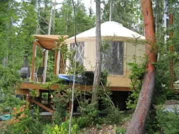

My friends are putting up a yurt which is a considered a temporary installation, but the owners want it safe. They have a Morso 2110 stove and will follow combustion clearances.
Does anyone have experience with this type of setup? Lessons learned? What would you go with, conventional DuraTech? The owners are open to creative solutions as long as they stand the test of time and aesthetics. Single wall, double wall? Better thimble ideas, pipe recommendations are all welcome. Here's a link from one company's recommendation. I'll also post a picture of an existing yurt with the flue somewhat visible behind it.
