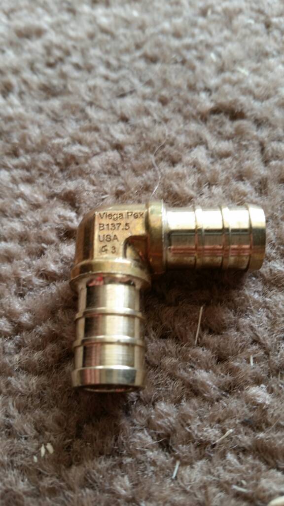

Viega, made in USA! This one 1/2". Bought it at the local supply house, and their prices were better than Home Depot.

That is odd. We only use Viega crimp fittings, when we're not running copper. Our Viega crimp fittings have either 6 or 7 smaller ribs as opposed to the 3 ribs that the one pictured has. I don't know what the difference is, but I have never seen a Viega fitting like that.
New style of fitting?
I don't think so. I bought Viega fittings their 8 years ago and they looked the same. I've never seen the kind with 5 ribs. I even looked on Viega's website and couldn't find them.....
Different fittings for potable water vs non potable water?

Here is what I'm talking about. Look under the crimp ring at the number of ribs. I will look for a better pic.
(broken link removed to http://www.ebay.com/itm/Viega-93550-PureFlow-Zero-Lead-PEX-Press-Ball-Valve-with-3-4-Inch-by-3-4-Inch-Pr-/181677215739?pt=LH_DefaultDomain_0&hash=item2a4cce4ffb)
Here is a pic of a stop without the crimp ring on. I never knew they had 2 different types of crimp fittings.
-I thought that style was push lock style or a pro press type fitting.
-So with this style the crimp ring is built in?
-Can the fittings be reused like the style I posted?
- The style I posted used the copper crimp ring, like the style you see at Home Depot, etc.
