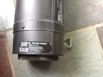

That's where mine was. It was one of these:
Damper
It was connected to the flue collar of the stove and then the rest of the double wall pipe went from there. For me, it worked great.
Damper
Can you use 3 screws to holding this into place? Does it slip over the mouth of the flue collar like my pipe does now? I don't see how this attaches at the stove.
Yes, there is a place to screw the pipe section into the stove collar.
Yes it does. Mine wasn't this exact brand, but it was the same style build. The label on mine reads "Simpson Dura-Vent Stovetop Adaptor"
Hopefully the attached photo helps to illustrate how the pipe section connects to the collar.
