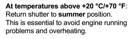

There is 1 other possibility that is worth mentioning.
On the inside of the air cleaner housing, at least on my 046, there is a sliding piece of plastic. At either end of the channel it runs through is a symbol. One side is the sun, the other side is a snowflake. When it is in the snowflake position air is being pulled across the engine thereby warming it before it enters the carb. In the sunshine position it pulls in plain outside air. I know it makes a difference in the winter having warmer air to burn. I never noticed if it heats too much in the summer when using the winter position.
I think you would have to be in a pretty hot place for that plastic divider thing to make a difference.
Reactions: mtarbert
You are likely correct, considering it is November. Right from the Stihl 044 manual:
[Hearth.com] 044 over heats
1. Make sure you're running 89 octaine or higher, and confirm you're using the right mix.
2. Get carb tuned, with your proper mix in the tank.
3. Make sure air fins are clear of debris.
I think I have had mine in the winter slot, well my 390, and been cutting firewood in the summer her in 90f heat. I never mover it from winter now.
