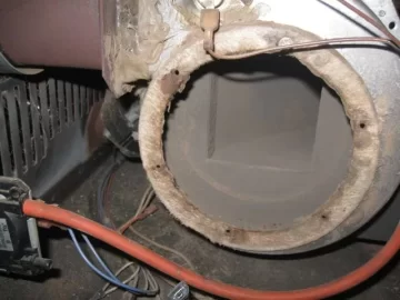

Pic 1 is the Combustion shroud with the blower removed.

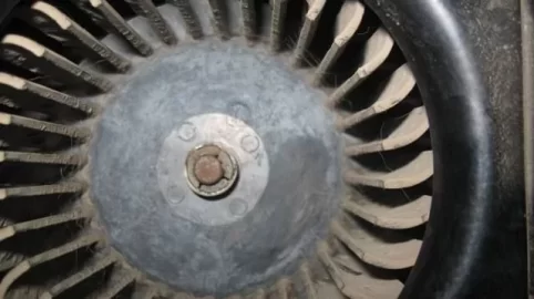

Pic 2 is the Combustion Blower (note the build up)

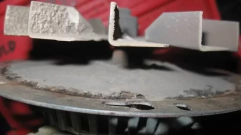

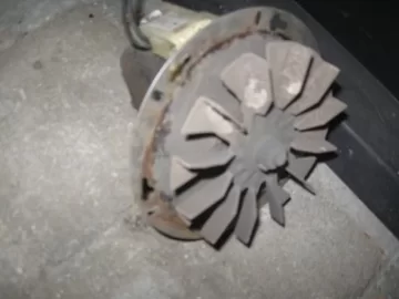

Pic 7 is a side shot to show what was making the squeal/noise.

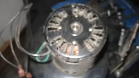

Pic 9 is the Convection Blower Motor side (Note the dust)
