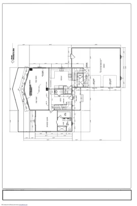

Hearth pad dimensions should not be significantly different no matter where the stove is located... If you are set on the T6, I can attest that you can locate chairs etc rather close and not get roasted. Floor plan drawing with dimension would help some of us address your concerns.
Here is the main floor plan with 2 squares representing either the corner install or middle of the room. We like the middle of the room, but it will likely use up a lot of floor space and be quite close to the couch. It's hard to tell but the room is 15' x 30' which sounds like a lot but really isn't when you start putting furniture in. A couple more pics of the corner option and where the pipe would go.

Can't see the floor plan that well with the picture, but regarding the central location, is that a solid wall or open into the the two rooms what would be behind the stove? And is the second floor above that open into this great room?

I would personally opt for the central location, especially if those two rooms and loft are open. And design a raised hearth as part of the room "furniture", enough room to sit on next to the stove etc. We were concerned with the traffic/flow etc when we added our hearth and T6 in the kitchen/family room. But those fears were unwarranted. You can place couches etc quite close to the T6.

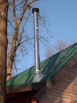

yes, the whole downstairs is wide open with a loft above. I know you can get things pretty close to the T6, it's just we don't want to make it look crowded. The builder confirmed the only reason they and the stove shop don't like the corner install is they're concerned that wind could topple the pipe even with proper bracing.
My stove is a corner install, as close as specified clearances (with a rear heat shield) will allow. The roof is a 12/12 pitch, with exterior rise of 12 feet. I have been in the cabin with 50 mph+ winds and the chimney hasn't moved. Unless you get a lot of hurricanes, I don't understand your builder's concern.[Hearth.com] 10/2 rule for chimney
