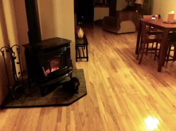

I attached a photo of the stove.

If you have little to no creo than I would say you are burning hot and clean. Maybe just a little too hot. Beautiful stove by the way. Is that a PE or enviro? If you have never done any gasket work I would start there. Replace all of the gaskets and adjust any door latches. Also you need to get a moisture meter for your wood. Any big box store will have them. Probably not tractor supply because tractor supply never seems to have what you need. Also get a stove top thermometer and a flue probe thermometer. It's not needed but I would get an IR thermometer as well. The magnetic thermometers are often not exact. I have three thermometers on my stove and an IR.
