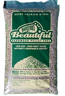

BAREFOOT EASY LIFT
Once Barefoot Always Barefoot. Produced in Troy, PA.
  • TYPE: Hardwood
  • WOOD: Oak
  • BTU / LB: 8530
  • ASH % 0.38
  • LENGTH ” 0.75
  • FINES % 0.17
Same great wood pellet in a New Easy Lift 23.8 lb bag!!
  • [Hearth.com] 1000sq/ft = one 50lb bag pellets per day???
