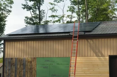

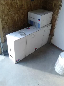

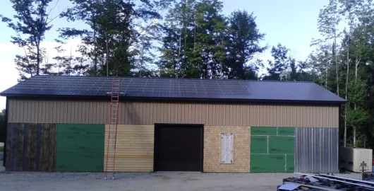

Day one of install was today.
Unfortunately.. I have to go back to work tomorrow and won't be here for the rest.
Good news.. Internet 'bridge' was able to work across my wires (install guys were unsure. about 500feet underground wire, and two panels to go through), and I now have wired internet in the barn, which will let me view solar array in real time via web.
A couple pics. Just boxes and racking.
JP
PS.. barn looks odd because my wife is a professional photographer. Different backgrounds for her to work with . The couple green ones are going to be a graffiti wall and a stucco wall. [Hearth.com] 12.2kw solar barn

Are you using Enphase microinverters??...what is your configuration....roof orientation etc?
Roof is 205 with a 4/12 pitch.
No microinverters.
48 Panels that are 255W
2 SMA transformerless inverters.
It should be making power Thursday. I don't get home till Tuesday. Power company came by this monday and put in my dual meters. I'm all set to go once they finish.

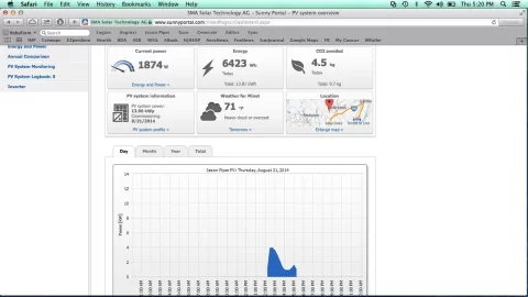

I SHOULD have web access to see production real time tomorrow... assuming they finish and set it up as promised.

Up and running on a cloudy day. Real time monitoring every minute via internet or app[Hearth.com] 12.2kw solar barn
