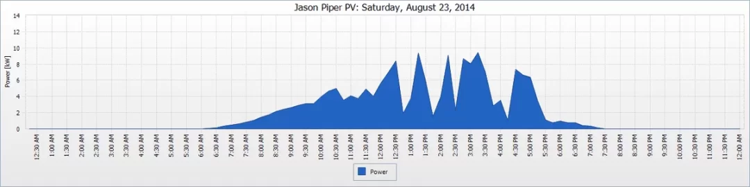

Obviously.. some clouds and sun. Still made over 45kw. PVwatts says I should be making about 50 a day in Aug. Still waiting for my first sunny day.
JP [Hearth.com] 12.2kw solar barn
Reactions: flyingcow
JPView attachment 137104

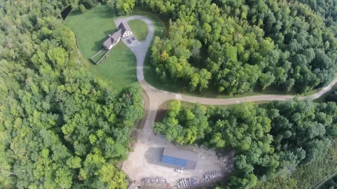

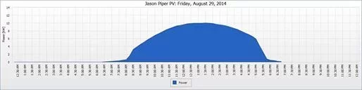

Had a 'perfect' no cloud day yesterday. Just passed 500kwh in my first 10 days.
And had a buddy stop by with his drone this morning. couple pics to share.
  • [Hearth.com] 12.2kw solar barn
I vicariously enjoy your satisfaction with solar electric power. Remains for me a little magical to see the power without doing any work to obtain it, just flowing from the sun.
Your picture evidences some shading potential in late fall and winter, roughly 6 weeks or so on each side of December 20. Sun azimuth is down to 19 degrees at my location (47N), and trees quite distant provide shading on my system. My calculation is about a 4% maximum shading reduction from estimated annual production.
I've got a couple trees to knock down. Gotta wait till I move the palleted up firewood, so I've got a good place to drop them. The estimator got on the roof with this camera. He took a picture of the southern sky. It plotted on the picture the path of the sun each month. The winter months it was pretty low, but he did say the few trees in the way would be leaf free by then.
We'll see
