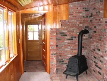

I just stumbled across this post/site after searching for info about my woodstove. I just bought a house over the summer that has this exact wood stove. Unfortunately, I don't know anything about it or wood stoves in general, but enjoyed learning what I could from this thread.
Any advice for a first time user? I have attached a couple of pics. Mine doesn't have the screen inside the door like the OP.

Hi myke,
Welcome aboard.
This link has just about all the info I have.
One thing I would recommend is the screen.
You would have to contact the gentleman I referenced in this thread who lives out by you to get one. If so it is well worth it. If that fails then consider making a very sturdy replicate.
It really helps. I love the stove.
I think your damper is suppose to be a few inches from the stove instead of that far up the pipe.
I have not decided on one yet.
I welcome any info from you also and thanks for posting.

Cool, thanks a lot for your help.
I'm curious as to what the benefits of the screen are. Does it project more heat? Does it burn better/hotter? Also, doesn't more smoke escape through it?
I haven't had any wood to try it out proper yet, but I need to get it going soon with how cold it's been lately.

Screen is great at start-up allowing maximum air in, and also to assist when things aren't burning quite right; and obviously to see the fire.
Smoke doesn't leak out.
Hi Myke,
That stove looks as though it's never been burned! If that's the case layer the bottom with sand and start off burning a few light fires. If the room is as small as it looks, the stove will drive you right out of it. I've burned that identical stove for 25 years and am still happy with it but if I had to use it for the primary heat source in the house I would get a modern more efficient one. Setting the air intakes on it is individual because it depends on the draft and how hot you want to burn. Typically the lower air intake is more open than the upper (which is said to burn any combustibles that get past the lower box). I burn mine hot ever since I had creosote drip down the pipe. Good luck and let us know how you make out.

Hi Fred,
Thanks a lot for the info.
I tried it out yesterday for the first time. It was just ok. I didn't put any sand down (hadn't read your post yet). I know the wood I have isn't great, I think it was just some old maple logs I had on the property already.
For the air intakes, I am completely ignorant about them. Should I have the bottom one open and the top one shut? I know they are all different but I need a starting point. Would does opening/closing actually do? I mean I can gather that open allows more oxygen so it burns more?
Also, I had some some trouble with smoke escaping at times when opening the door; any tricks on that?
Lastly, no this is not my primary heat source, but I'd like to use it to supplement a bit. Also, next try I will have to get some better wood.
Thanks!
Myke,
The bottom air intake is for the main burn. The top one is a kind of afterburner that provides oxygen to burn uncombusted gasses. My guess is that it only works when the stove is burned hot. I keep the bottom vent open three quarters of the way, the top only a quarter. I hardly ever change them. As for smoke, if some comes out when you open the door you don't have enough draft. If your pipe is going into a large chimney space or if it's too long or has too many right angles or the geometry of the roof is causing wind to blow down or . . . .!!! Too many Ifs. Burning the stove hot may solve the problem but your best bet is to get someone knowledgeable about stoves to look at your setup. Smoking up the house is no fun: I've done it. Good luck.

Myke,
Here's some links for you:
http://home.comcast.net/~ratline/Firewood/Woodstove_Energy_Harvesters.pdf
http://home.comcast.net/~ratline/Firewood/Energy_Harvester_patent_description.txt
http://home.comcast.net/~ratline/Firewood/Energy_Harvester_Patent_US4407265.pdf
Also just as Fred pointed out, the bottom one is the primary air regulator and the top is the secondary.
I recommend using dry wood only.
Try getting a screen or get one prefabbed. It really helps for start-up.
If you can't get a screen then both regulators need to be wide open for start-up.
You can gradually close them down using your pipe and stove thermometer as a guide at a rate of 2:1 top:bottom.
Here's a link to a thread with a pic I took tonight.

Thanks a lot for all of your help guys! I Tried again today with more success, but still need to get better wood. But yeah, thanks again for all your help explaining the air regulators; great info for me...

Your stove and install look great and I love the woodwork in that room.. Have you been running the stove and how well does it heat?
