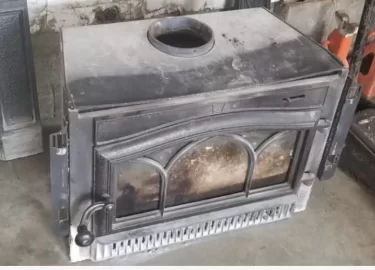

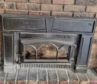

I have heard Jotuls are good stoves. I ran across this wood stove insert for sale by me - asking $650. The blower doesn’t work. (I am hoping I can buy a new one and replace. Is this possible?) They have owned it for 9 years. Were these stoves efficient when made 9-10 years ago? I thought there was an air wash on them, but the glass in this one is so sooty. Do you think they were burning wet wood or small fires that did not get hot enough? I also heard that since the Jotul stoves are cast iron, they are hard to light and get going. (I also have a 35-40ft chimney, does this add to the mix?)

The 350 is a good unit, but a bit small. It's hard to say from just this picture but that insert does not look well cared for. If the paint is actually turning grey, walk away.

The “shroud” (the top part of insert that resembles sheet metal) appears to be caving in in middle part of the insert. That would have to be repaired before use unless I’m looking at an optical illusion.

I agree, this unit looks a bit off. The parts that appear gray tend to be in areas that I would not expect stove to get overheated. I does not looked very cared for though.

I gotta agree with the others. That stove looks like it was beat on. Maybe from being too small and running it hard to make up for it.
Very hard to tell from pictures but everything is grey, stove, bricks all of it. I'm not surprised the fans stopped working, prob caked with ash. If the fire brick and upper baffles (inc skamol) are intact it may be OK but if the fans are not repairable you should know the replacements are not cheap. If that's the case you can prob do better or just go with a New Englander as mentioned.
