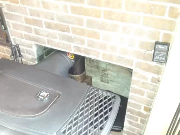

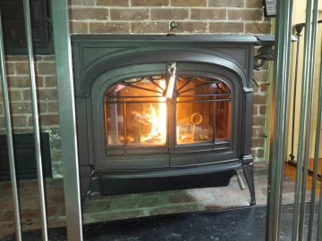

I'm home sick from work, its 50 out and my wife took the kids for a ride so I couldn't resist doing the first small break in fire. Just a half SC and kindling this time. Hearing lots of snap crackle, maybe buildup inside the cap falling, have to go up and check it before next fire.
[Hearth.com] 2013 VC Burning Thread
Window fan is on high ;)
Snap crackle went away after 5 minutes. I added a couple small pieces to get the griddle temp just shy of 300 then let it burn out. Pipe temp barely broke 200, draft seemed suprisingly decent for a 50 degree day (thank you no more damper) but it did smoke out the front door when I opened up to add a piece. Shouldn't do that once its get colder and I fire it hot.
It smells a bit funky in here but I dont see the new paint smoking off yet. Going to be nasty on the next fire I bet when I try to get 'er up to 500.

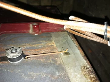

Put in the secondary probe, cat temp probe, catalyst, catalyst acess panel, bolt in the side panels (checking the thermostat cable is clear this time), pace the lower fireback and hammer in the wedges, place the hood, replace the ash grate, and bolt in the andirons.
The hood that covers the catalyst opening it looks like in pic 4 it is inside? Mine is on the outside... difference in models? Or is mine backwards LOL
Im not sure I follow you... what do you mean by inside / outside? post a photo?

It was just the lighting on your picture. The hood looked like it was inside the fireback and I was like o_O
Ha. Yeah I had a drop light clipped to the griddle while i was working inside. It casts funny shadows.

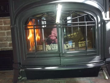

Break in fire #2 kindling and two 4in splits. Just got to 400 griddle and 350 pipe.
Still the only thing I smell is the oil on the griddle cooking off. Prob won't start baking the paint till I push past 500???

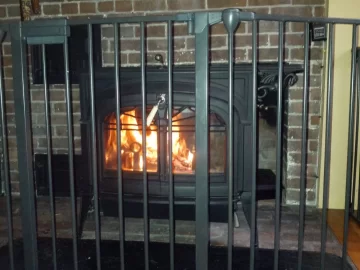

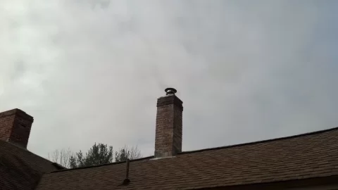

Final break in fire today to cure the paint. 40f outside, 3 splits of extra extra dry stuff that's been in the indoor Woodbox all year.
Windows open, fan going. Got it up to 500 in under 30 minutes and the cat lit off like a freight train.
Now I have air at minimum and it settled in at 525 stove top, 1250 cat, 300 surface temp just a few inches up the pipe. A lite plume of white steam outside.
Paint fumes have been surprisingly minimal.

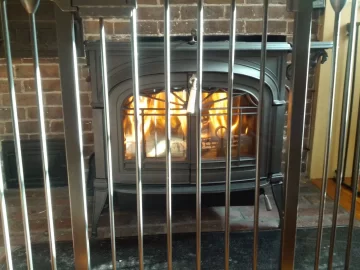

[Hearth.com] 2013 VC Burning Thread [Hearth.com] 2013 VC Burning Thread [Hearth.com] 2013 VC Burning Thread
The thing I don't like is that I'm getting pretty good flame in the boxeven at low air. Usually it would go almost completely dark. All the gaskets seemed to pass the dollar test, and I can see with a mirror the primary is closed completely.
I'm trying to pass a match around looking for leaks, nothing yet.
More checks. I am seeing the expected change in flame intensity as I open and close the primary. Maybe its just the super dry wood, having the windows open and the fact that the stoves air passages and flue are cleaner than they have ever been since I owned it?
Later this week I'll recheck every gasket again and go around looking at the seams some more.

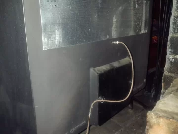

Ive had some requests to show how the catalyst probe installs.
- On the back of the stove you will see a sheet steel plug above the secondary intake. Pry it off with a screwdriver.
- Using a 1/4" drill bit held by hand, carefully twist it into the refractory to make a hole.
- Slide the probe in place as shown below.
- I wired the cable to a screw on the secondary cover just so it wouldn't move if I bumped it accidentally.

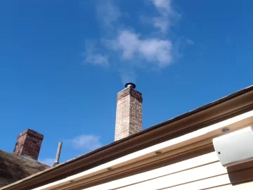

November 3, 2013
Ok, yesterday I was outside in a t shirt, and even had to use sunscreen becuase the back of my neck flet like it was on fire!
Today its 40F with wind gusting to 20+ ... so....

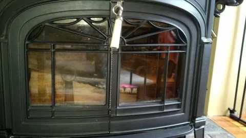

First serious fire of the season!
I lit off at 11:38am with 1/4 SC, a couple pieces of kindling and 3 small splits
In 10 min it was blasting, I added a couple more larger splits
At 12:05pm the griddle read 550F so I shut the damper and in under a minute the cat lit off and climed through 1000F.
Right now we are cruising on a half load of wood at just under 1/4 open on the main air control with 550F griddle and 1600F cat. Exhaust looks completely clean outside.
As soon as the living room gets up to 74 or so I'll shut 'er down and probably reload after dinner.

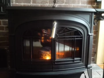

And here we air with the air fully closed. 600 griddle, 1500 cat.
A lot more flame in the box than I remember last year with air closed, but maybe that's due to the stove breathing better and very dry wood? All the gaskets seem good.
Upside is that the glass is staying cleaner than ever.

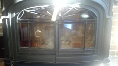

3 hours later.... Sun came out and outdoor temp went up to 45f. Stove is down to coals but still about 450 griddle. The living room is an oven... 79f. Since its not looking as cold as predicted I'll let it burn out.
Not bad performance for the statup wood and a couple medium splits... I still wonder if its breathing too well and will check all the gaskets and the adjustment of the primary air one more time once its cool.
The glass stayed completely clean and for the first time ever I saw nothing but heat waves out of the stack... I'm calling this rebuild a success :ZZZ
