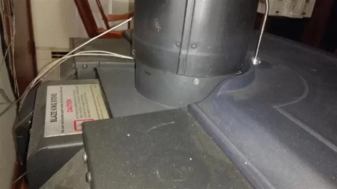

  4. oldbluedeer
    oldbluedeer
    New Member 2.
    Oct 24, 2017
    93
    21
    Scott Bar, CA
    Is this the right forum to discuss BK installation issues? I installed it this summer, and one concern that I had was the very loose connection between the BK stove and the Duratech doublewall black stove top adapter. As the adapter sits on the stove top, it is not a nice tight connection. There is a tapered inner piece on the adapter that goes inside the stub coming out of the stove. The outer portion of the adapter slides down over the stove stub, but there is a rather large 1/4" gap between the stove stub and that outer wall of the adapter. And the adapter just sits on top of the stub coming out of the stove, and it isn't tight or secure at all, just the weight of the pipe coming down that holds it in place there.
    I had been having a slight smoke odor starting to build each time I shut BK bypass, or later after when I had reached full operating temperature and dialed the damper back for the long slow burn. So yesterday as a short term fix I stuffed some stove rope into the gap between the outer wall of the adapter and the stub piece on the stove.
    It seems to have helped a lot, but before proceeding to stuff even more stove rope into the gap, I wanted to get feedback from this group...

  6. Poindexter
    Poindexter
    Jun 28, 2014
    1,882
    703
    Fairbanks, Alaska
    @oldbluedeer , i had a collar adapter like that on mine when it was newly installed.
    In my AF 30 there was room to just take the adapter out and set the double wall telescoping pipe over the stove collar or stub pipe.
    The clearance between the pipe screws and cast iron top is best expressed in thousandths, it is plenty less than one eigth of an inch all around... but it does fit without scratching anything up and my smoke smell went away.
    I do have to lift the cast iron top plate off my stove to get to the screws to brush the pipe bottom up.

  7. oldbluedeer
    oldbluedeer
    New Member 2.
    Oct 24, 2017
    93
    21
    Scott Bar, CA
    Thanks for that. It helps to know that I am not imagining the whole thing!
    I like that the Duratech double wall adapter covers both inside and outside of the stovetop stub. One issue is the three holes in the stove top stub, where with the single wall adapter you can attach screws there to hold the adapter in place. With the double wall adapter, I cannot put a screw through the holes, and as a result they are free to let gasses flow outside into the room. I think those holes may be the main place where gases are escaping out of the piping and into the room
    I am on the fence as to either switching to that single wall adapter, or fixing what I already have. I am leaning toward trying to fill those holes with JB Weld Extreme Heat, and then stuffing even more stove rope in the gap... I'll reply to this post with the results, one way or the other.

  8. kf6hap
    kf6hap
    Jan 15, 2016
    575
    261
    Nevada City,Ca.
    That is what I did. I crammed it in real tight to form a seal. The cold air entering was spoiling some of the draw.

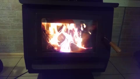

  17. lsucet
    lsucet
    May 14, 2015
    812
    238
    San Ysidro, New Mexico
    Details over a 20 hrs burn using pine. See all the coals left at 20 hrs later. Seen the inside temps at this time i can get easy two more hrs out those coal before reload. Since last night that i dialed it in. I didn't touch anything till now to rake the coals from under the ashes.
    IMG_20171201_231957573.jpg IMG_20171201_232818236.jpg IMG_20171201_233945825.jpg IMG_20171201_234029775.jpg IMG_20171201_234115055.jpg IMG_20171201_234433918.jpg IMG_20171202_065052596.jpg IMG_20171202_065104039.jpg IMG_20171202_065124874.jpg IMG_20171202_065208521.jpg IMG_20171202_115920715.jpg IMG_20171202_120039382.jpg IMG_20171202_162034361.jpg IMG_20171202_162041962.jpg IMG_20171202_162141824.jpg IMG_20171202_192116151.jpg IMG_20171202_192144051.jpg IMG_20171202_192208103.jpg IMG_20171202_192549237.jpg IMG_20171202_192604136.jpg
    Stop hovering to collapse... Click to collapse... Hover to expand... Click to expand...
    Nigel459, redktmrider and Blazing like this.

  25. WES999
    WES999
    Jan 12, 2008
    1,033
    312
    Mass north of Boston
    I too, used the cut down Amerivent All Fuel Single Wall Adapter, attached it to the stove pipe first, then assembled the pipe to the stove
    and used 3 screws through the stove collar to attach the adapter.
    Worked great.
