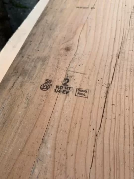

I got about 40 boards of 4 ft by 9 inches Heat treated/kiln dried scrap wood from hipster part of the Brooklyn. It is an entertainment place of some sort of darting that uses a lot of soft wood boards. The store manager said they are all pine but he doesn’t know what types. I may get more from them in the future for free.
I intend to use them along with Black Locust to make Black Locust get going.I have a limited storage space so to use it as the most efficient as possible, almost 80% of my stash is Black Locust. I didn’t mix Black locust with any softwood before. And I am not sure if it is a good idea. I mixed BL with oak last year which was our first burning year. BL and oak mix lasted long and I think a good combination for overnight burn. But sometimes we felt that we need an immediate burst of heat so I am thinking BL-pine (soft) board mix would work. It may also eliminate excessive coaling issue that we observed BL-oak mix during the day.Am I thinking right?
If I am not mistaken I remember Jetsam mentioned that he is using pine in the coldest time of the year for quick hot fire with no coaling issue. Last winter, when I and wife both were working from home, we observed too much of coaling during the coldest times of the year. I think frequent loading was the contributing factor. But taking it from Jetsam, with pine mix or with mostly pine load i hope that would help eliminate coaling issue during the day.
My only concern is that I read on the internet that burning pine produces black smoke. I dont want to disturb the neighbors. If I am not mistaken, some members of BK family uses pine exclusively. What is your experience about burning pine? Does it produce black smoke ?I was told I can get continuous supply of pine boards. Some of them labeled as Doug Fir. Some of them labeled as S P F which means spruce pine fir.
I happily burn Norway spruce almost exclusively, and never noticed black smoke (while the cat is engaged). Burning time with the t-stat at 5 o’clock is 12 hrs, at 3 is 24 hrs. All my reloads are on a nice bed of coals, just right to restart the stove in minutes. BK are ideal stoves for softwoods IMO, to the point I feel no need for hardwood at all. Of course, I have lots of space for my wood piles, so storing space isn’t an issue for me.
Do be sure that the wood is not treated with any chemicals, or the cat will be damaged (poisoned as they say).

It is not treated chemically. It was the first thing I asked. Also from the lumber labels, it doesnt show other than it is kiln dried. Thanks for the feedback. I cut the boards in 16 inches size. Since they are very dry, I assume they also help to balance out not so perfectly seasoned firewood with MC content of %23.

Looks like Douglas fir. I’ve burned a few loads of the same, no problemos

The pinkish stuff on the top is doug fir. The stuff on the bottom is probably pine.
Both are fine in the BK if your gaskets are in good shape. A combo of bone dry dimensional lumber and black locust is potentially dangerous for a new stove operator in a non-thermostatic stove, though, so this isn't a general endorsement for that practice. :)
Pine smokes like any other wood. If you're burning properly, it won't smoke at all.
