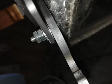

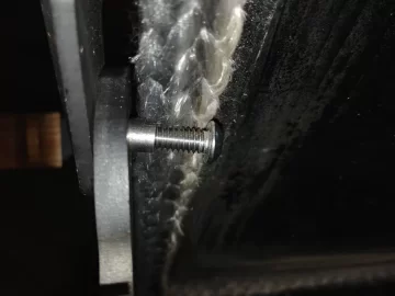

I'd probably hammer and file that original tee nut back into service, just use anti-sieze on it from here on out. Finding a new one isn't going to be a matter of going down to Home Depot. (They do sell tee nuts but they're punched for use in wood.)
You're right - but I decided to abandon the whole weld nut/tee nut idea. It just seems like it's going to be a pain in the future, unless I grind flats on the nut first. The local Ace had a variety, but most were punched as you say.
If you have a pair of calipers handy, measure the diameter of the fastener and the spacing between threads (I like to measure 10 threads and divide by 10 to reduce measurement errors).
It turns out to be simple - 1/4 by 20. I replaced everything with stainless, using a pair of jam nuts. The handle hole is a lot bigger than 1/4 (forgot to measure) so I lined it with a sleeve. Works great! Naturally it's too warm for a fire now.

Stainless steel galls badly during disassembly. I would suggest using anti seize.
