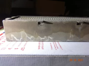

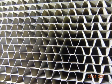

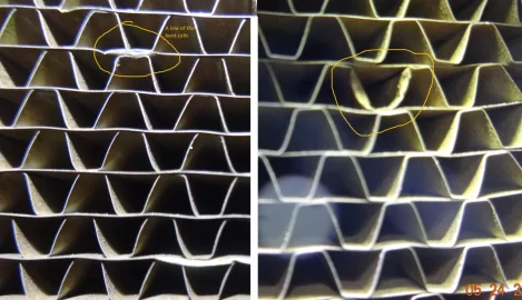

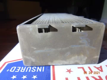

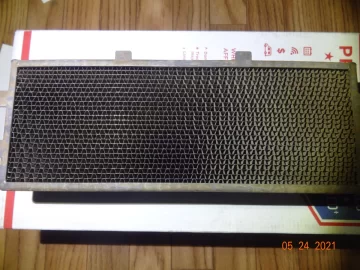

I have enjoyed my Blaze King Sirocco 30 for about six years. This year I noticed I had to keep my thermostat on much higher to keep my combustor in the active zone. So I think it's about time for a new one. So I order a new metal one and received it today. It came tapped in bubble wrap with no gasket on it. Do new ones come in a OEM box? If it was new, shouldn't it have a gasket on it? I guess I have to contact them about that. This is my first time ordering a new combustor. I have no idea what a new one looks like. I'm just worried it might have been pulled from a used stove since supply's are so low. I wont be able to test it until fall. Is there anything to look for to make sure its new? Color, texture, etc? It has almost a yellow bronze rusty look to it. Here's some pictures of the new one. There's also a few bent metal cells. Not really happy about that, but will that affect the performance? Thanks a bunch for all your help! It's really appreciated!

Your description of the color sounds right. Kind of yellow brown, when burned will get more grey. Smell it for smoke if you think it’s used. You ordered this from BK or from an Amazon vendor like Midwest? My last few have been ceramic and came gasketed.
You need a gasket no matter what you’re told.
It’s most certainly a new cat. You’ll need to order some gasket for it though.
The color is due to the wash coating - its thickness makes it this color.
The cells look good to me. Like the cat that came with my new stove.
Thanks for the reply's everyone. I was gonna order a steel one from Midwest but all they had was the ceramic ones. Can the Sirocco use the ceramic one as well? Wasn't sure so I ended up ordering a metal one from Hechler's. Hopefully they are ok to order from. The new one looks like my original which is good. There's no smoke smell from it either. I contacted them about the missing gasket and they sent me one, which is great!
Is there any threads with pictures on how to install the gasket? I remember there was masking tape on the one that came with my stove. Is there any glue or does it just get taped on? Also do you over lap the two ends of the gasket or butt the two ends together? Thanks again for everyone's help!
But the two ends of gasket together. Tape all around the edge of the gasket conbustor interface on the back side of the combustor, plus a couple wraps all the way aeounf, about a third of the way in from each end.
The combustor with the gasket taped on just slides into its hole. Not sure about stamped metal ears, my Ashford 30 has them and I think we have identical internals. I have to go now, I will check about about those dad-gone ears when I am free again. Once you have done it once it really isn't hard. It just slides in, and then the tape burns off when you light the stove again.
Overlap the gasket and then cut through both layers with a utility knife for a nice clean splice.
With the combustor out there is a stamped sheet metal ear on both the left and right sides of the hole. They fall out easily. One of their functions is to serve as part of the hinge mechanism for the bypass door, so the bypass won't work right if they are malpositioned.
If the combustor slides in like putting a coffee mug into a kitchen cupboard, the ears are either not in, or in wrong.
When the ears are in correctly there is a fair bit of friction to slide the combustor home. You are supposed to be able to do this blind while kneeling on tip toes, so "a fair bit" of friction is a relative thing.

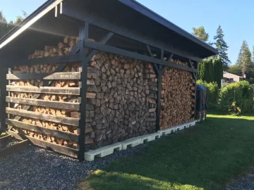

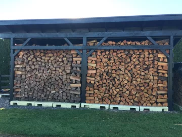

Just yesterday I finished stacking 5.5 cords of stove chow. Found something buried in the freezer to celebrate.

You drove by my house and didn't even stop to help me stack wood!! Shame on you! I think I'll go home and rummage through my freezer and see what I can find. Nice wood sheds!

Dang, you definitely will get warm twice with that wood. Gotta love chelan. I’ve got access to a cabin built out over the water back in the 60’s. That first dive off the deck is something
