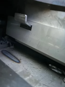

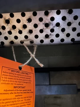

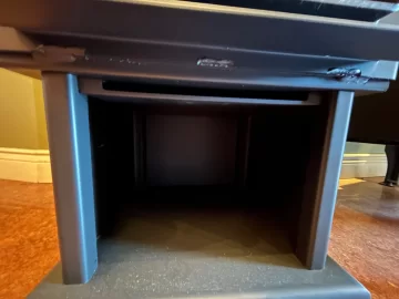

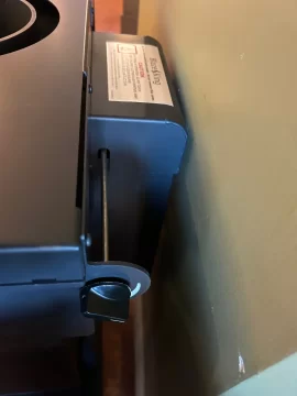

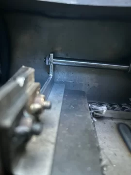

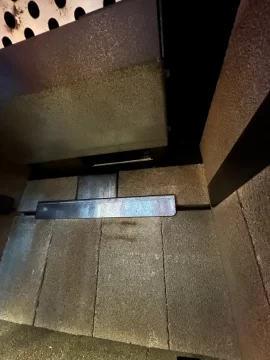

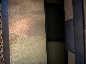

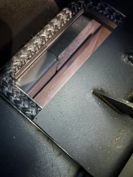

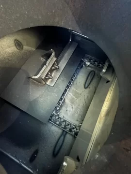

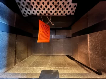

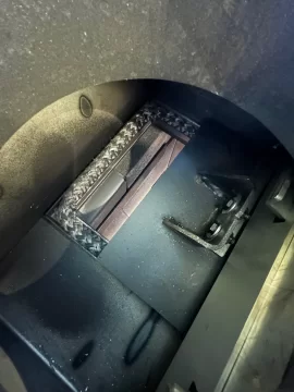

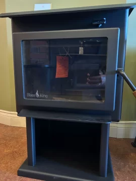

I was able to stop in this week to get a few more pictures of the Sentry, especially of the bypass.
I also realized that the BK Boxer 24 has the same type of sliding bypass damper as the Sentry, so at least we have a model with a similar setup which has been in the market for several years.
Really loving the Sentry. Probably going to pull the trigger on it soon..

I see the gasket is in a U channel. That'll help.
Good to know the boxer has the same bypass indeed.
Is the Sentry a radiant stove? I don’t see any side convection panels. The clearances are awful close for a radiant stove.

Looks like you can lift off that metal curtain from behind the cat to allow pretty easy access to the area right behind the cat for cleaning.
The bypass plate doesn't look really thick. It feels like 1/2" thick on the princess and I'd think they would want it thick so it would be heavy enough to help seal and not warp.
Since the bricks go all the way up the sides this stove may not need exterior heat shields to stay relatively cool for those low clearances. All stoves are radiant and convective to some degree.
It almost feels like they listened to the stove nerds and fixed some of the flaws of the previous stove models. Maybe some new blood in the BK company not stuck on old design elements out of pride.
Looking forward to user experiences. The Boxer stove is the way it is because it is an insert firebox on a pedestal.
Too bad BK doesn’t design a reversible flue so you could vent out the back if desired.
