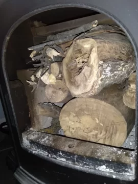

I posted some about the way I load this stove over in @bikeshopguy345's thread, but here is a good example of what I aim for. That's a 7" diameter round on the bottom and then I pack wood in around it to fit. I'd use splits if I had them to fill in - I just have a lot of branch wood from this tree which is perfect for this size of stove. All of this is mulberry with the exception of some maple kindling around the crumpled paper. It's been 2 days since I've needed a fire so this is a cold start, top down. If I were starting within 12-24 hours of the last fire, I'd rake the coals to the front left corner of the firebox, put kindling on it, and then otherwise generally fill the firebox as shown in the pictures. This guarantees me lots of coals for matchless relights 12 hours after starting, and usually enough 24 hours after.

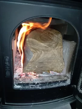

Here's another good way to get a long burn. I may have a small fire when the sun starts going down if the house didn't heat up much during the day - basically just enough to burn down to a nice bed of coals by 10 or whenever I'm planning on going to bed, and will want to load the stove up for the night. I was able to split this chunk of mulberry down just enough to where it would fit. For reference the width of the door opening is 9 1/2". With the very low moisture content and the nice bed of coals it burned down well.

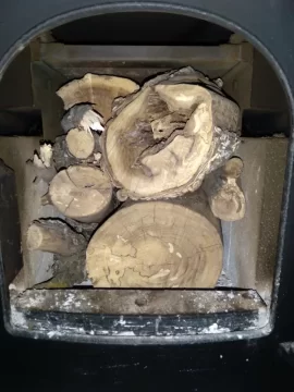

I like to load up rough cut tamarack 4x4 cutoffs when I'm going to bed for the night. I still had coals this morning at 0700 after loading the stove at 1900 the previous night. Maple would be better, but got to work with what I've got!

It sounds like these little N-S loading cast iron stoves just perform well, backed up by the efficiency numbers. It's also a lot easier to pack them full for the night. Trying to do that with an E-W loading stove like a Lopi Answer or Vogelzang 1120 may theoretically be possible, but you either have to cut a ton of short splits to load N-S, or try to keep stuff from falling back against the door with E-W loading. The Aspen C3, Morso 2B, etc. can pretty well be crammed full with no worries, maximizing the amount of firewood and burn time.
I agree. If you have to, you have to. But if you can avoid E/W loading, you'll be much happier.
I load my encore and defiant all the way up to the griddle top E/W.
Yep. Only time my doors open up is if it’s a cold start.
That makes sense for those size of stoves. I can see how it's easier to pack a top loading E-W stove vs. non-top loading ones. I guess the VC Intrepid is top loading, so it's probably the most comparable in this size class, with a firebox that's 0.05 cubic feet larger than the Aspen C3.
How do you split your wood? As in sizes and shapes.
I don't split any more than I have to. Most of the trees here on the prairie aren't huge and definitely not tall, so I end up with a lot of rounds from the limbs in the 3-5" diameter range. When I do get bigger stuff out of a trunk I may split the base pieces (usually 16" diameter max) into quarters. Stuff in the 8-10" diameter range gets split in half since I have no shortage of smaller stuff. This stove is very happy to burn thick pieces and you can always make them smaller later if you need to. Big pieces are more of a commodity for me for overnight burns.
I try and square off all my splits without creating an abundance of kindling. This helps eliminate air space between pieces of firewood.
