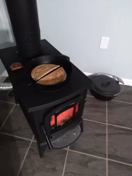

It's been too warm here for fires (60s and 70s!) but I did get a cast iron dutch oven after some measuring and some research. The cooktop circle on the Aspen C3 is right around 9 3/8" diameter inside the lip, so any pot with a bottom diameter of 9 5/16" or less should fit on it and be in direct contact with the cast iron, not held up by the lip around the edge. Lodge doesn't give bottom diameters for their cookware on their website so I went into Cabela's and grabbed a fish measuring stick and felt where the bottom of the dutch ovens were through the boxes to measure diameter.
I can report that a 7 qt. fits about perfectly. Definitely can't go any larger if you want it to fit on the designated area. If I do any cooking/baking I will start a separate thread in the appropriate forum, but figured someone looking at this stove in the future may find this info handy as a reference.

It's a Lodge 7 qt. Mine is the version with the bail handle as that's all Cabela's had in stock. They appear to have another 7 qt. that does not have the bail handle for slightly cheaper and I would think would have the same measurements. Here's the one I got: Link

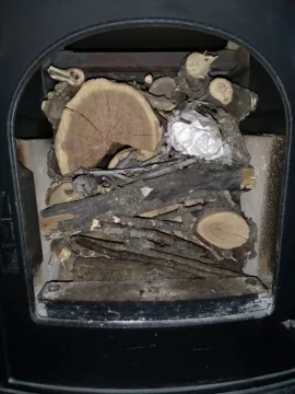

It's finally looking more like December here. Into the 20s last night and not getting out of the 30s today with a 20 MPH north wind. I started a fire at 10:30 last night. I packed about as many 6" chunks in as I could fit, with some room for kindling towards the front at the top. This is the most I've had the stove loaded so far:
I've gotten things down to where I can leave the door barely cracked for the first 5 minutes or so while keeping an eye on the kindling taking off, and then I can shut it and walk away. Here's what things looked like at 5:30am - still a few blue flames showing not coming out well in the pictures from my cheap phone:
And here's 10:15am when the house had dropped down to 63 and I reloaded. The stove top was around 125 degrees. A few of these coals were peeking out from the ashes and I uncovered most of what you see here, put some smaller sticks on top of them and then some splits, and had flames and shut the door a couple of minutes later. The stove had cooled down enough that the intake damper was back open for this reload.
Overall I am happy with the automatic air control. There are times I wish I could shut the air down sooner, and times I wish I could open it for 10 minutes when I reload on a very burned down coal bed, but I'm extremely happy with the burn time for a stove this size. Since I still had flames from the coals at 5:30am, personally I would easily consider that to be at least a 7 hour burn time. I went back to bed and didn't check it again until a couple hours later. I should be able to go longer when I'm sticking full 16" splits into it instead of a tetris pile of 6-8" chunks sized for the previous fireplace, and also longer when I'm reloading on hot coals and not taking up space with kindling starting from a cold firebox. VC claims 10 hours and I really think that's achievable from what I've seen - with the right size and type of wood, and after you get used to how to operate it.
I am waiting to put in a rating for the stove on this site until I finish the first season, but so far I'd say 4.5/5 stars.

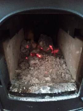

I started a fire around 8:30pm the other night and had enough coals under the ashes for a reload at 7:30am-ish the following morning. I forgot to measure the cooktop temp before loading but it was probably 150-200 degrees tops as it was still noticeably warm, but the intake damper was about half open and no coals were visible on top of the ashes. I did put some ~1/2" diameter kindling directly on the coals I had uncovered and then larger splits and rounds on top. With the door cracked I had a roaring fire less than 5 minutes later and I shut the door, and watched it for maybe 20 minutes. I noted this in the Aspen C3 temperatures thread but for documentation here:
425 degrees 18" up on exterior of single wall pipe
750 degrees center of cooktop
625 degrees between cooktop and flue exit (insulated beneath)
Those are the the highest temps I've seen so far. The flue temp was significantly higher than anything I've seen before but that makes sense on a reload, since most of the stove was still probably around 150-200 degrees or so and it took off very quickly. The flue temp dropped after maybe 10 minutes and the cooktop center was getting closer to 700, so I stepped away for a bit. That makes sense with the damper closing as the temp probe heated up. An hour later it was back up around 750 again and I don't know what it may have gotten up to during that time, but I'd be surprised if it got to 800. And if it did, that's still below the max temps observed in the EPA testing, if we assume worst case that their firebox top temp probe was over the uninsulated cooktop and not over an insulated spot, as I suspect it may have been.

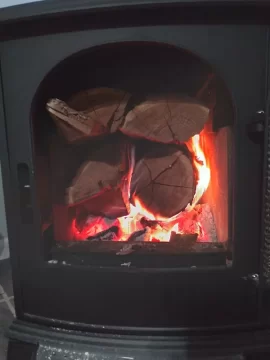

I promise these long posts will slow down when I quit breaking new to me barriers. I started a fire from scratch at 7:30 this morning with mostly smaller 3-4" honey locust rounds. I didn't touch it again until 10:30pm tonight and I could see the top of a coal peeking out, and to my surprise I uncovered several decent sized chunks (see attached picture... tried it with the flash on but then you couldn't tell they were glowing coals). That's what, 15 hours after I started the fire and I hadn't put any wood in since initially loading at 7:30am? Obviously I would not count this as burn time as the heat output was next to nothing by 10:30pm (stove top was ~100 degrees). However it makes things pretty easy for restarting. I have been leaving a decent amount of ashes in the firebox which helps maintain coals.
I put some kindling and progressively larger pieces on top of those coals. Almost all of this load currently in the stove is dead standing mulberry that I cut a week ago and is consistently testing 14-18% MC so I figured why not try it. I have a ~5" round and a ~6" half split on the top - finally cut to ~16" long since this stove is designed for that length, vs. the pieces I cut from previous seasons that were much shorter for my old ZC prefab fireplace.
Holy guacamole. That mulberry took off like nobody's business after having the door cracked open for about 5 minutes to get it going. For 10-15 minutes I was seeing these temps - the highest yet:
450 degrees 18" up on exterior of single wall pipe
855 degrees center of cooktop
760 degrees between cooktop and flue exit (insulated beneath)
This only lasted maybe 15 minutes but it was exciting. I'm curing paint that hasn't been cured before. That 855 is just under the max that was seen in the EPA tests - again, if they had their location at the center of the cooktop, which is the hottest spot. It has since settled into the 650-750 degree range. I think if I saw 900 I would start getting concerned. There's no wind tonight so that is not in play, and it's still in the mid-40s temp wise.

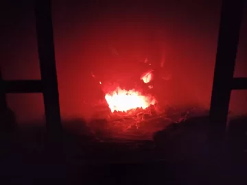

Well, I did see 900. I'll keep most of that discussion over on the thread dedicated to Aspen C3 stovetop temps. I do have this picture of what I started with (smaller rounds of honey locust, mulberry, and silver maple), and then what was left 13 hours after I had started the fire. That was easy enough to reload on. Wish I'd been awake around 10 hours into the burn to see what things looked like.
It has gotten much colder here (down into the single digits at night) and I am happy to report the stove is heating my ~750 square foot house just fine. In general I was reloading every 6-7 hours, with splits and rounds as shown in the 3rd picture. I've seen some other discussions on here about dealing with the coals in this stove (and others). It does coal up a lot with the honey locust. The trick has been to make sure I get my house up to 70+ and then let the coals burn down on their own. There is still a surprising amount of heat output but it is obviously reduced from a roaring fire, and I'll lose temp in the house when it's 10 degrees with a 30 MPH north wind as it's not putting out quite enough BTUs to sustain temp. If I time it well I don't have to reload every 6 hours, or have to deal with a mound of large coals in the firebox. I can reload when it gets close to 62 in the house and the coals are pretty well burned down.

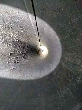

3. The nut holding the stovetop to the LH side (pic below is inside door, looking to the left and slightly up) was not completely loose, but not tight. I retightened this and made a note to check the ones at the top rear when I take things apart for cleaning after the season is over. The RH front nut was tight.

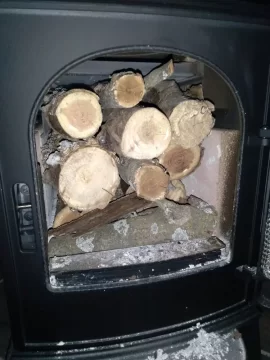

The other night we were steady around 35 degrees evening to morning. I packed the stove full in the evening and when I left to run into town the next morning there will still active blue flames on the coals and I had a 350 degree STT... 9.5 hours later. The pic isn't great through the soot on the door glass but you can kind of make out the blue flames and the large lump of coals towards the back of the stove. It was still going, too, so I'm going to consider this easily hitting the 10 hour burn time that VC advertises. This load was a mix of honey locust splits and rounds with a 6" diameter round of mulberry right in the middle, and some smaller mulberry rounds and whatever random long kindling sticks would fit filling in the voids. You really have to pack it, and at 35 degrees with little/no wind those were probably ideal conditions for a long burn time. Anyhow, it's definitely possible under the right conditions.
I did have to put the brakes on with the blast gate at the peak - maybe an hour, hour and a half into the burn for 15 minutes or so and then I could turn it loose again.
