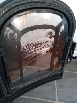

Here is a picture of some of the stuff that sticks on there during the end of a burn. I was midway through razor blade scraping it off (I did not scratch the glass despite what it may look like). Thanks for the tip. I am convinced that is the only way to remove this stuff. I wiped with wet ash for quite a while first and that removes the top sooty stuff decently but left this gunk.
Reading around in old threads for other stoves there may be hope it burns off if I get things hot enough? I have only had the rear 1/3 of the firebox full so far, so maybe between having a larger fire and it being closer to the glass, it will be less of an issue? We'll see what happens now that I am starting with a clean slate.

This glass is very black. It looks like fuel issue to me. I have not cleaned the glass on either of my cat stoves in three seasons (what is the point on a cat stove) and it does not look this black. Brownish yes but not black like that

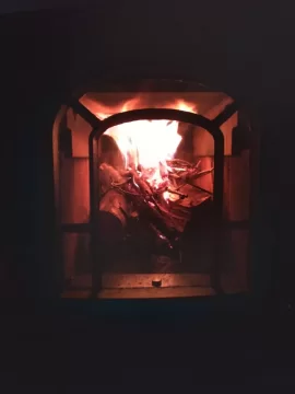

It barely hit 50, was gray, and we have the usual 20+ MPH winds today so I am having another fire tonight. It should get into the 20s by the morning. I took the opportunity to try a sort of top-down fire based on some of the recent posts here and I was blown away. It's absolutely the way to go, especially with the Aspen C3. I loaded the wood more in the middle of the stove this time instead of the rear, to see if that helps keeping the door clean. I am still only running it about 1/3 full since it is bringing up the inside temp very well in this type of weather.
I did have some smoke spillage out the intake when I first lit the fire, which hasn't happened before. I don't think it would've been an issue if I had gotten the door cracked/closed quickly instead of leaving it fully open for a few minutes. I can also confirm that checking with a match resulted in no leaks detected around the door.

I am happy to report the door glass was cleanable without a razor this morning. The below picture is after a quick wiping with almost no elbow grease. The rest of the stuff required some more vigorous rubbing but it all came off after a few minutes of effort. I built the fire closer to the middle instead of the rear of the stove, and I think all of the paint and other substances inside are pretty well cooked off by now. That baked on black stuff did not make an appearance. Fuel is the same 3 year+ seasoned locust and mulberry that I used previously.

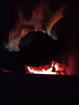

Another thing I noticed with the fire in the middle is that some flames do lick towards the glass, so there must be some combustible gases available there in addition to the usual flames up along the baffle that I am used to.

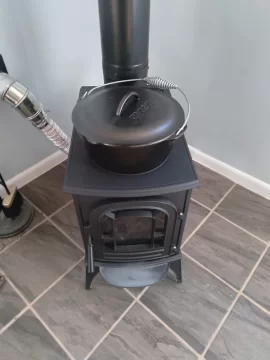

It's been too warm here for fires (60s and 70s!) but I did get a cast iron dutch oven after some measuring and some research. The cooktop circle on the Aspen C3 is right around 9 3/8" diameter inside the lip, so any pot with a bottom diameter of 9 5/16" or less should fit on it and be in direct contact with the cast iron, not held up by the lip around the edge. Lodge doesn't give bottom diameters for their cookware on their website so I went into Cabela's and grabbed a fish measuring stick and felt where the bottom of the dutch ovens were through the boxes to measure diameter.
I can report that a 7 qt. fits about perfectly. Definitely can't go any larger if you want it to fit on the designated area. If I do any cooking/baking I will start a separate thread in the appropriate forum, but figured someone looking at this stove in the future may find this info handy as a reference.

Unless cooking something that needs high heat, you may want to add a trivet underneath to avoid scorching on the bottom. I regularly use a dutch oven to slow cook dishes and stews on the T6 trivet top. It works great.
