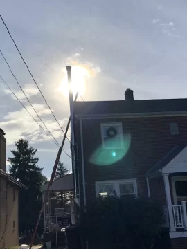

I have 21’ of exterior class A, 24” of horizontal into 2 45° and 24” vertical into stove.
The chimney exits above my roof peak but about 12’ away toward the lower eave. I have about 7’ above the roof.

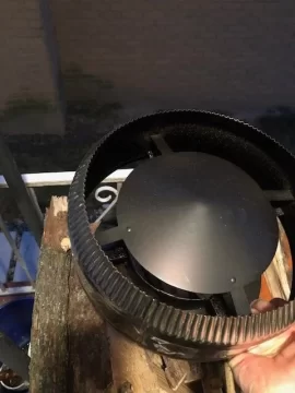

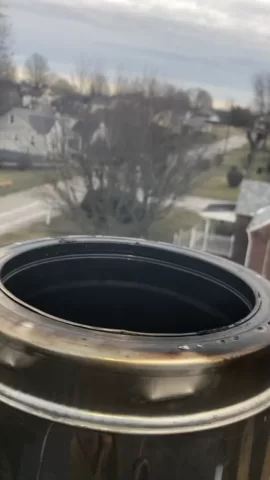

The Menards Supervent system came with a chimney cap that I installed but it’s to restrictive. So I took it off, great draft when it’s established which is very hard to do.
Supervent (Selkirk) is sending me a less restrictive cap to try.

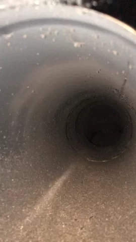

Looked at the manual quickly while monitoring my F45 startup. Are you sure the bypass is opening, that chimney should draft great.
is your wood dry?

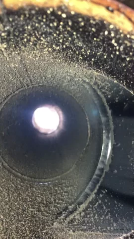

Your chimney might be partially blocked with creosote if you've been having issues and burning bad for a while.

Yup How dry is your wood?
I had the twist on cap like in your pic and changed to the newer style retained by a ring. it is less restrictive but I didn't see any change in draft, just easier to remove for cleaning. I'd clean your chimney and see what happens. That is the only reason I've had poor draft is buildup of creosote.

Does the quality of wood matter if my paper and cardboard aren’t even combusting completely?
Yes, because your chimney may be so gunked up from burning bad wood that you can’t establish draft anymore, even if you’re only using paper and cardboard.
A common buildup location is in the horizontal pipe and at the tee.

Probably not yet. This is a great illustration of what happens when hot flue gases hit the cold exterior chimney and do the draft-slowing 90º turn at the Tee..

New install and still having trouble.
