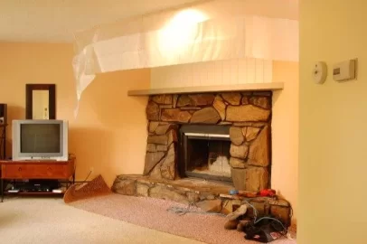

Here is my old ZC fireplace, a heatilator:
[Hearth.com] 3-2-10,  a good place to start.
Notice this was back in the day of CRT type televisions, and I have a plastic curtain already attached to the ceiling and a scrap of carpet padding on the floor for upcoming demolition. I have also retired the 3/8" chuck drill since this picture was taken...

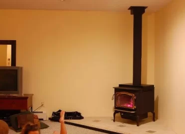

And here, you may judge by the ankle - happy wife, happy life - after I removed the ZC and put in an EPA cert non cat - in 2013.

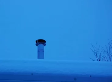

Here is a chimney shot of the first burn in the EPA cert non cat before I had to go do man stuff with the wife in front of the stove....
According to my records this was 11-10-2013.

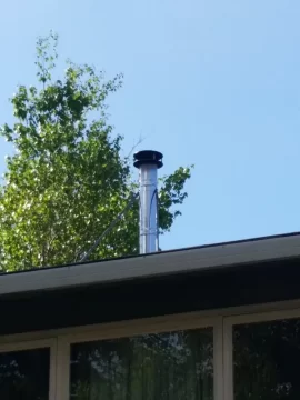

After the ordeal, when my birches leafed out, I had this from the other side of the house:
I pruned that sucker back to flat dirt. I put my anger and frustration into digging the stump out the way I learned in archaeology class, with a trowel and a hatchet. All better now.

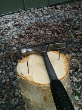

Along the way, I pinned the stump to see where it was when the ZC came out and the new chimney went in:

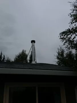

After terminal pruning of the offending Betula sp I have this view from the south looking north, see post one above:
I should be fine on 3-2-10 now. My local ordinances require 1 tree per bedroom, I have 5 bedrooms and 11 trees with trunk diameter > 1 inch. If I need to terminal prune a couple more, they are going down like a, well, going down like a thing christian men aren't supposed to know about.
