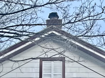

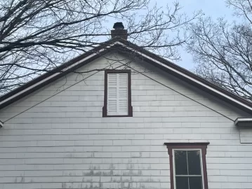

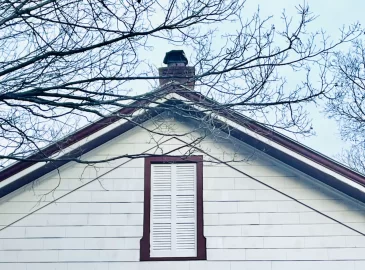

I have a feeling there are two separate 12x8" clay lined flues in the one chimney.
begreen
Mooderator
Staff member
Nov 18, 2005
91,415
South Puget Sound, WA
It's why I have been asking for picture of that chimney top.
Bethany Waterfall
Oct 28, 2021
22
schoharie, NY
Here's a picture of the chimney top. The chimney sweep was excited to hear that the stove could be used with 6" pipe and is very happy to replace the baffle set and keep the stove. He says there is 23' of pipe. The shuttered window is the full height attic. There is one 90 degree elbow from the pipe coming out of the stove where it connects to the brick chimney & clay liner (you can see that in the photo of the great hall below) He recommended using two 45 degree pieces to minimize the horizontal run.
We only ever had one liner and one stove running up through the brick chimney (I had it relined when I bought the house in 2000). I will have to take a picture of the woodstove that was in place when I bought the house. It's pretty amazing. Basically, a massive iron round bonfire box with the classic faces of tragedy/comedy on sliding doors. I replaced that with a VC Defiant in 2000, and then with the Canyon in 2011. It is a heating beast and supposedly 78% efficient, though emissions are about 2.5g/hr.

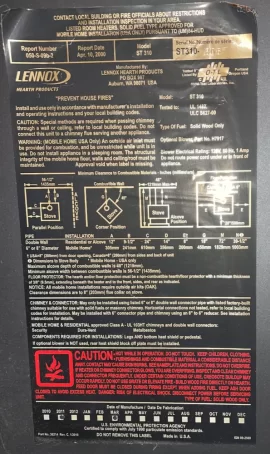

(previous post edited and corrected manufacture date of Canyon :) Thanks to ABmax24 )
Screen Shot 2021-11-09 at 5.57.41 PM.png Screen Shot 2021-11-09 at 5.42.27 PM.png
Screen Shot 2021-11-09 at 5.42.05 PM.png Screen Shot 2021-11-06 at 4.44.53 PM.png Screen Shot 2021-11-09 at 5.47.00 PM.png
ABMax24
Sep 18, 2019
1,327
Grande Prairie, Alberta, Canada
And I double checked the back of the stove and the Canyon is from 2000, not from 2011 as I had previously thought. We bought it new in 2011, so not quite sure how I picked up a brand new 10 year old stove.... But it is a heating beast and supposedly 78% efficient, though emissions are about 2.5g/hr.
View attachment 285097 View attachment 285093
View attachment 285094 View attachment 285096 View attachment 285095
April 10, 2000 is the date of either UL or emissions certification.
Look at the bottom of that tag, date of manufacture was March of 2011.
