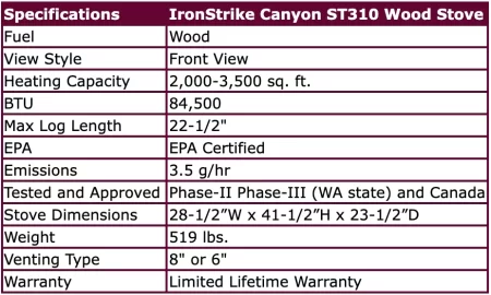

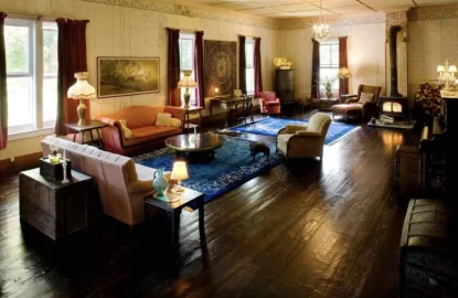

Unfortunately the clay liner in chimney in the upstairs 1500 sf Great Hall is cracked so, I have to reline the 12" chimney. I have 10 year old Lennox Canyon 310 with an 8" flue up there now, but it seems I can fit two 6" stainless flues in the chimney, so I thought I would replace the stove with an Osburn 3300 or 3500 and then add another woodstove in the 1000 sf Dance Hall directly below the great hall (which is currently heated with a Rinnai heater on an "as-needed" basis).

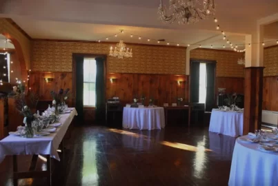

The ceiling of the 1500sf great hall is foam insulated, but the walls are just plaster and lathe with a second layer of plaster on the exterior for old school "insulation". When it's freezing out, the Canyon does a pretty good job of keeping the room warm enough (along with the 5 bedrooms around the great hall -- as long as people sleep with their doors open). The Canyon is a beast, but burns a lot of wood -- and man, it's a lot to hump all that wood upstairs.
****so... first question... will the Osburn 3300 output the same kind of BTUs as the Canyon 310? Would the 3500 be better ? Or, am I barking up the wrong stove replacement tree? specs are below, but when I called Osburn, they said there was really no difference between the stoves and they would produce the same amount of heat? Is this true in the real world, as opposed to spec sheet world? Also. I use the eco-fans as I really hate blower noise, but I would be OK to use the blower intermittently on the 3500. I also have ceiling fans everywhere to move heat around.

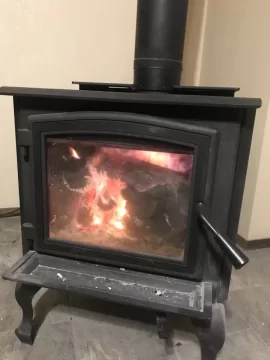

I have a Lennox S160 (from 2003) in the downstairs 450sf living room. The kitchen is in the next room with 3 bedrooms upstairs. The 160 with a 1.6 cu ft firebox is undersized and I wake up pretty freezing every morning. The owner's quarters side of the house is somewhat insulated and has gone through various renovations, but I am finally investing in comprehensive new insulation in the basement and attic crawl space, which will change my life significantly for the better. After looking thought the archives and threads here, I think that the Blaze King Chinook 30.2 would work really well and I will certainly appreciate the burn times! However, I am not prepared this season with super dry wood. I had issues this summer with wood delivery and am worried about moisture content. Will I ruin the catalytic converter if the wood isn't dry enough? Would it be worth it to get a season of kiln dried wood? From what I have described, would the Chinook 30.2 be a good choice?

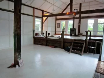

The third stove (Lennox S160) is in the 875 sf barn studio (insulated but not very tightly with 18 foot ceilings). I'm leaning towards replacing it with the Osburn 3300, although I am considering a catalytic instead. still not sure...
