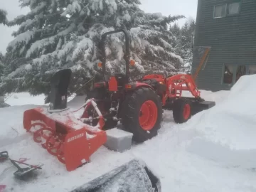

I have a blizzard 74" that is amazing. I do have the next size up Kioti, but I think it would work for you as well. I bought it through my dealer. Initially I thought a fro t mount would be nice, but having the bucket on front and blower in the back is awesome. I have only dealt with snow so far by hand, with my Husqvarna walk behind, and this setup. A plow on the front would be nice, but the snowblower just makes it all go away.
  • [Hearth.com] 3-point snowblower thoughts
Reactions: EODMSgt
My first time using it I did break a shear pin, but I did the same with the walk behind. Unfortunately my dealer forgot to include some extras, so we used the walk behind and the bucket to clear snow that day, which was the last big snow anyway. Make sure to check your turnbuckles and top link occasionally while using it, they like to vibrate loose on me. Same with the land plane as well.

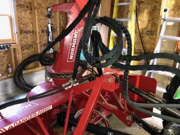

Screw looking over your shoulders. Get an inverted blower. Space Bus is welcome to share the picture of my Normand 82".
Came to say exactly this. Life's too short to be backing up to clear snow everywhere you go.
Eh, front mount blowers are quite expensive, so I don't mind driving backwards and then also have the ability to have the bucket on the front.

Here's the pic Bad LP sent of his setup. The inverted units do look like a nice setup, but when I got my blower I only had one remote. I don't mind manual control and driving backwards, but I suspect that one day I will tire of it. Maybe then I'll get a back blade and a front mount blower.
