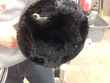

I posted this earlier in another thread and had a request to make a dedicated thread for others that may experience similar issues. Long story short, I had an old Clayton wood furnace for my building and installed the chimney straight up, through the roof and was above the 3' for 10' rule. I got the stove up and running, constant back spilling and insufficient heat....smoke was bad. Couldn't get the fire box temps up. I questioned everyone and researched what I could. Everyone that saw my setup thought for sure, "without a doubt" my chimney was plenty high above where it needed to be. I was a bit frazzled by this for 3 weeks straight. I came home one night and had enough. Only thing I could try that I hadn't done was add 3 more feet of chimney! Boooom! Old girl took right off and ran like crazy! Hot hot fire, no spillage and very little smoke outside considering what I was working with. This picture shows what can happen after 3 weeks with this problem on a brand new chimney. Crazy huh!

It's quite amazing! My chimney was well within spec but I believe the surrounding woods on the north side and another roof line for my house to the southwest caused a weird air pattern. Anyone with a similar problem needs to try a little more length before giving up.....if I hadn't seen the difference first hand, I wouldn't had believed it.
We see quite a few posts every year that have just met or are near the minimum chimney height requirement but still their stove is performing poorly. Sometimes adding as little as 18-24" makes a large difference. Chimney location, local terrain, and stove location all play into this equation.

Wood furnaces can be notorious creosote machines if they are forced to idle when heat demand is low. Add semi-seasoned wood and you can plug up a chimney quickly. Yes, modern stoves really like good wood, but actually dry wood helps all stoves burn cleaner, old or new.

What your picture is showing was initially glaze, and with a hot fire it expanded. Begreen is right, many times problems can be from a furnace that's too large for the home. If that's the case, burn smaller hotter fires, or once things are cleaned, burn it hot for a couple of minutes a day. Unfortunately, whenever I thought I was doing good in our old furnace, I would find this in the flue. It doesn't take long for that to happen.
You are right except that was not just a hot fire that was a chimney fire that is burnt creosote without a doubt.
Yep......it was on fire. I'm almost positive of this. It was on my last fire before the pipe was added. The chimney was ticking and sounded horrible. It didn't get to the super glowing red hot stage but I'm pretty certain it was on fire. I hurried and shut the damper in the pipe and the stove down tight and it mellowed out. Subsequent 24-7 burns for the last 3 weeks or better with the extra 3 foot and an nc30 in place of the dragon and it's all good!
Good glad it is working better for you did you look over the whole chimney good after the fire? It honestly doesn't look like it was all that bad but you should still check it out
Looking at that picture makes me ill. I'm a nervous wreck now, paranoid and reaching for my expansion ladder!_g
