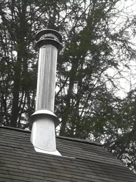

In the process of installing new pipe for my new stove and am switching everything from 8" to 6". I am wondering if theres a way i can get away with using the same 8" roof boot so i dont have to get into the shingles. Has anyone had any success doing this?

And they make flashing w ith oversized bases for this exact situation. Regardless do you really want to rely on a 30 year old peice of flashing anyway?

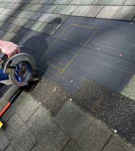

Dont be intimidated to remove shingles. I have worked on a few roofs in my life and I use a cake spatula to separate the tar strip and a wonder bar to lift the nails.

Thanks guys for all the replys, i will be replacing the 8" boot. Tearing shingles up dont bother me, did it for years as a carpenter.
Good deal. That will allow the installation of high quality chimney pipe and have the optimal venting for the stove.
So i thought i had settled on replacing the boot but had another idea lol what if i drop the 6" pipe through the 8" boot and use one of the chimney pipe support brackets to keep the chimmey in place? I beleive there is a code that if the chimney is a certain heighy you must use one any way correct?
