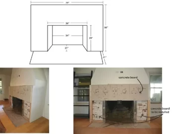

I'm not sure if the C550 would be overkill. We need to know more about the setup and the house layout. Is the room open to other rooms so that the heat easily convects out? How many sq ft total will the insert be heating? What is the size of the fireplace opening and what is it's depth?

I've tried to attach a pic and measurements of the FP (not sure if I'm doing it right). The opening is 36", width in the back, 34." Depth is not quite 21." The opening at the front is 29" high but it gets short at the very back. The back wall height is 14." But it's 24" tall 5" from the back. We fit the Jotul c450 in there with no problems.
