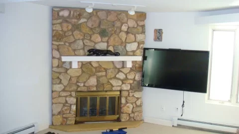

Yah its just in my movie room, to provide heat there. It happens to be the lowest level of the house so I was hoping some of the heat would rise to the upper levels. But yah, its mostly for local heat, looks etc. I tore out an old Heatilator fireplace which was completely useless for heat! So I'm hoping this will work out well.

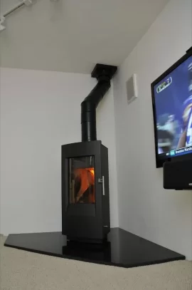

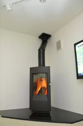

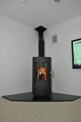

Well my project is finished! I will never do it again!! Oh my gosh was that a lot of research and WORK!
Some of you wanted to see the Hearthstone Tula in action. I made a quick YouTube video so you can see it. I'm very happy with it. Its actually so hot I probably need to go buy a fan that can move the air into the other rooms easier.
Enjoy!
http://www.youtube.com/watch?v=5GQ8DeaD3ns
Wow! That looks great. Very nice work.
If it's as hot as you say, you might want to relocate that TV.
Man that is an awesome install. Hell of a nice job there, the black granite looks incredible with the fire going in that sleek stove.
Shawn
Thanks guys! Actually the tv just gets slightly warm on the edge. But yes I was concerned about that as well when I lit it.
I'm burning some pretty dry willow in it now. I might try oak, maybe it won't burn as fast and as hot.
Wow! Very "clean" and obviously functional setup. Congratulations!
That fire looks beautiful and so does the stove and hearth. If you need it, you could create a discrete heat shield for the side of the tv screen. Done right, you would barely notice it.

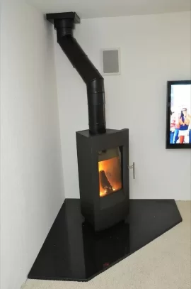

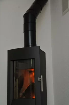

One question: how close is the connector pipe to the wall up at the ceiling support box? It looks close, but the angle of the camera makes it hard to tell. Can you post a couple stills of this beauty here too? I think you are the first to post about owning one.
BEGreen,
That 6" pipe coming out of the ceeling support box is only 4.5" from the wall. I know this isn't the minimum 6" from a combustable wall, so what I did was I made that corner, in that area, "non-combustable". I put a metal stud behind there, no insulation, and used concrete board. The wall is a poured concrete wall behind it. My insurance guy said that is perfectly fine. I had the stove roaring today and that section is warm to the touch, not hot at all. The rest of the pipe easily makes the 6" clearance.
Here are some still pictures. Hope you like them.
...Timbers
