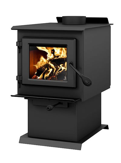

So here is what I'm working with. I just took out a huge Brunco stove. I just didn't like it and I'm beginning to see why. There was not liner. The stove itself took up most of the fireplace opening. I do not want an insert. I much prefer to have a stove. I have been looking at the Vermont Castings Aspen, but I'm concerned about the auto dampening do hickey. My dimensions are to work with here are 26 inches high, I have more than 36 inches of depth, and 36 inches wide. The opening to the flue is 7 inches so I think I'm good there. But there will more than likely be a little elbow in there I'm guessing.

If going with a stoveyou want it infront of the fireplace not in it. If you want something in the fireplace get an insert

And not a radiant stove. An insert is convective and can be put in without the front surround in some cases.

Any recommendations? I guess I should entertain an insert...I really don't wanna go with a surround. Much prefer a stove but just not sure what to get.
Regardless of what you get, include an insulated block off plate, especially if the chimney is on an outside wall.

An insert without the surround. Drolet is a good value.

A Drolet Escape 1800 or a TrueNorth TN20 insert will work.
