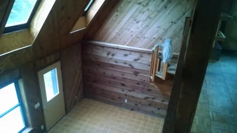

I'm looking at installing a Summers Heat 50‐SHSSW02 in my newly acquired 1800 sq ft home. I've been researching stoves for quite a while and I think this is my best fit for the money that I can spend currently. I'm putting the stove in this corner of the bottom floor. The door will be gone next summer.
[Hearth.com] A little guidance please
I'm wondering about the chimney system. I'd prefer to go through the wall as the roof was redone appx. 3-4 years ago, and I don't want to poke a hole in it. I'm not completely against it, but I hate introducing a possible leak point in a good roof. No matter what I do, there's going to have to be a 30* bend appx 6' up from the top of the stove. I figure I could follow the roof line for 4-6' and then send it outside via a 90*. After that it'll go vertical appx. 8'-10' to the cap.The manual says to use 6" pipe, but it scares me to go that small with a 30* and two 90*'s, with one of them being an abrupt T. Tips, tricks, recommendations? Thanks

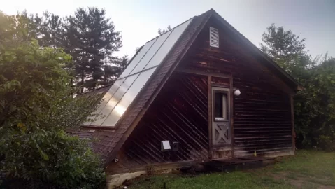

Oh yeah, outside shot of the opposite side of where it'll be coming out. As you can see the roof on the opposite side is lower than this side.

I think you are gonna want to stick to the 6" pipe that is recommended by the MFG. A 30 Deg and two 90 Deg bends in a total of 16 ft of pipe could bring some issues along with it. If needed would it be possible to extend the total pipe length by a few feet to compensate? If "yes", then I would bet it will work just fine. The Summer Heat is not known to be a real easy breathing stove, but not a miser, either.
Even if it means poking a hole in the roof, consider whatever method will give you the straightest run. A properly sealed pipe is nothing to worry about but the straighter the pipe is, the better for multiple reasons.
Personally I think you will be way better going up instead of out of the wall. One reason is draft. Straight up is best and the pipe is staying warm in a longer run. Which is also the next point. Putting the pipe outside your losing alot of potential heat that you would have off of the pipe inside.
Reactions: beatlefan
I have the same stove with two 45's and it's just over 15. I think it's 15'6" roughly and on warmer days draft can be finicky until I get her going. I seem to recall something saying not more than 90 degrees total in elbows so that may drastically cut down your draft. Just something to think about
The pipe will be inside until it either goes outside or goes through the ceiling. That'll be appx 12' of single wall. I'm guessing total length of the system is going to be 20-22'. I could make it taller, but it wouldn't be aesthetically pleasing if I keep going up with it.
I'd have to see the complete floor layout but were it me (and the door is gonna be gone) I would put the stove and hearth where the door is and go right up through the middle of the sky lights. Done properly there's no issue with a hole in a roof.

tell us about the solar panel setup
Go through the roof. Done properly it will not affect the roof sealing at all. It will vent better and will be much easier to keep clean.

Well, since the consensus is through the roof, guess I'll go that route. I used to be in construction and have seen way too many roof leaks.
Stove has to go in the corner. The windows that are next to the door are going to turn into a 3 panel sliding glass door.
I wish I knew about the solar. I bought this house as a foreclosure. The reservoir/ tempering tank and pump aren't there anymore. I'm also unsure if the system even holds water. I'll start messing around with it next summer. I know that it's a passive heating system that has air flowing underneath the slab. I can't wait to get it working again. Figure I'll start doing in depth research in the spring.
