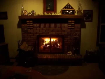

Alright maybe not 1000. Me and my wife just bought a new house, I've now got an open faced fireplace. I've had a few small fires in it but we've always said it's for appearance, it didn't seem to put out much heat unless you've got your feet in it. (Which is great until your socks catch on fire!)
It's got:
1) Glass doors and chain curtains
2) A flue
3) A top and bottom vent
The master bedroom is above the room with the fireplace and the chimney runs right up the wall past it. I said to myself, "Myself, we should be able to build a fire and not have to run the oil heat!
BOY AM I GLAD I FOUND THIS FORUM BECAUSE I HAVE NO IDEA WHAT I'M DOING.
For whatever reason, we can have fires but they might warm the room a little, but I feel like I'm not getting the performance I want.
My procedure is:
1) Open flue
2) Add wood
3) Set wood on fire
So basically I'm not adjusting the flue (tips?), not using the glass doors, and not using the top and bottom vent. I keep the top closed and the bottom open and leave the glass open on the fireplace with just the chains shut. Any and all advice is appreciated.

I've enjoyed fireplaces for many years. But they don't heat a house. I discovered, during a power outage, that mine pulled so much outside air in that the house was actually getting colder! Sure, it's warm right by the fire, but unless that fire is going 24/7 and you use an acre of wood, it won't warm beyond the immediate the space.
Get a stove. For best results extend your hearth and put it in the living space, not the basement.
Welcome to the forum. You're going to get pretty minimal heat with an open fireplace regardless of how you operate it. With a big bed of coals and a radiant 'fire back' you might get a little heat into the immediate room, but you're sucking in a lot of cold air to replace what is going up the flue. Closing the glass doors just cuts off all the radiant heat to the room and makes the situation worse. You can't really close the flue on a fireplace or you risk smoke and fumes backing up into the house. There are some types of 'Heatilators' or heat exchangers which you can add to fireplaces to recover a little more heat, but for any type of real heat, you'd have to go with an insert or free standing stove. The heat would be about the same from either, though an insert will require a fan because it is set deep in the fireplace. A freestanding stove can work without a fan since it is exposed, though a fan can help circulate heat to other parts of the house.

Cant tell by your picture if you have vents above the fire box to let some heat out or if it's just a plain old ambiance type fireplace? Some fireplaces like mine are called heatalator or heatform and have supply and return vents around the firebox which will throw a ton of heat after the fire box gets heated up, but they still burn a ton of wood and aren't as efficient as an insert. I burn mine once in awhile and it's nice to have a huge fire view and traditional fire at times.

Thanks for the replies. I'll do some research elsewhere on the site. From what I am reading - a fireplace insert is the way to go and makes roughly the same amount of BTU as a stove if I have a blower on it.
Also thanks for the tip about the top vent. I leave it closed. I'll try it with it open.
