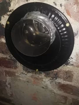

We had a 4" rigid liner installed in our masonry chimney in preparation for the installation of a pellet stove.
We just received the stove and I was about to order the pipe to connect it to the Tee coming out of the chimney but I'm not sure if an adaptor is required. Would you be able to confirm? Liner is flexmaster "ZR" rigid 4" stainless
Attached is a picture in case this helps.
Thank you!

Yes you will need an adaptor
from liner to the pellet stove pipe
Thank you. Any idea what they are called? I can find stove pipe adaptors but looking at icc liner, vortex and Selkirk (three brands I'm able to find in Canada) I can see that they make an adaptor for the stove but I can't see anything for rigid liners...
