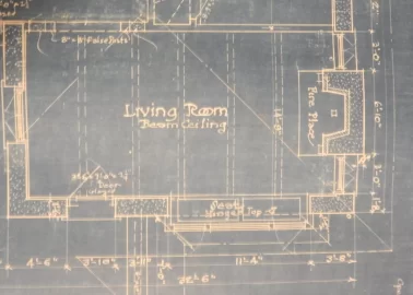

Can you post a sketch or describe the floor plan? Maybe post a picture of two of the room showing the door way(s)? Is there a basement below?
Of course. Here is the original blue print of the room. The entrance to the room is on the top left. The door marked on the bottom left goes to the outside. [Hearth.com] Advice for a Stove/Insert in a massive fireplace.

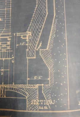

Here is the cut-away of the fireplace:
1. Location: Outside of NYC
2. There is a crawlspace below the room. I had toyed with the idea of somehow hooking an insert into a venting system which would make use of the old under floor coal heat registers, but forcing hot air down seems silly.Again, a hydronic system would be better suited, but almost nobody seems to execute these.
3. There is nothing above the room. There are high velocity air AC ducts, but using an air handler to run in reverse and somehow pump the hot air into other rooms, while sealing off the outside air also seems more trouble than it is worth.
4. Right now the only heat distribution method we have are two ceiling fans in the room.
There does seem like an opportunity to heat more than just the room. The large opening into the ?? area (upper left) will help. To do this you would put a return duct outside of the room in an area needing heat. The return would be connected to a well insulated duct, with a quiet,inline blower, to a supply register near the insert. This will start a good convection loop pushing the cooler air toward the stove. That air will be replaced with warmer air from the stove room. This doesn't require a big blower, Panasonic makes quiet bath fans designed for inline remote use that are quiet and work well.
