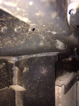

I have learned so much already from browsing this site (thank you!) and now I'm hoping for a few more words of wisdom and advice. I am looking at purchasing a used Isle Royale. It looks to be in pretty good shape, but I'm no expert so I'm hoping to line up someone a little more qualified to inspect it for me. But I'd also like to hear from others about what to look for. And other things only an IR user might notice, that kind of thing.The dollar bill test was good, but what about the cement seams, etc? (I really don't know what they're supposed to look like after the stove has been in use). I attached a few photos. The stove is 10 years old, and apparently unused for the last 3 or so years. I understand they are discontinued but parts should be available for a while?

That doesn't look like a problem, you would feel some nice radiant warmth, but at that distance it shouldn't be uncomfortable. Besides that, the two issues to consider are that the stove has been discontinued and parts eventually will be harder to come by. And the stove is more complex than the other stoves under consideration. That said, it is a very well-made, veteran stove that does not have a large track record of problems.
