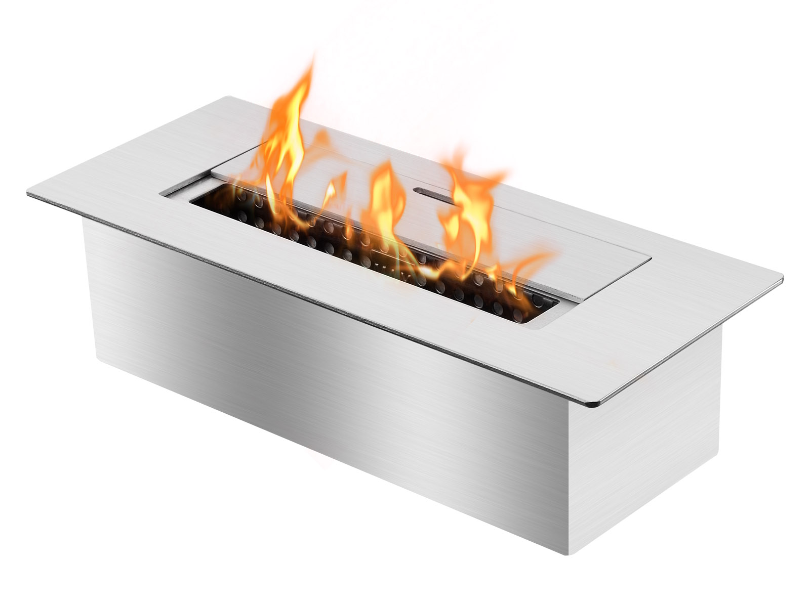

We burned ethanol in ethanol burners for a couple years. It was nice. We used three of these (or maybe the bigger one)
