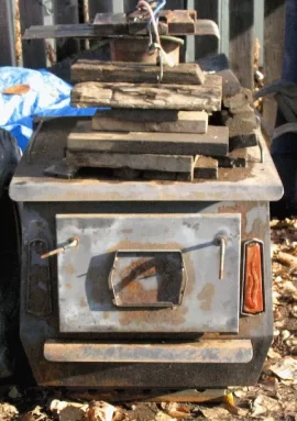

(broken link removed to http://southbend.craigslist.org/app/4121332133.html)
I saw this... which made me think about the electric blower, and if it was really necessary for it to operate effectively should there be no power.
Well, at least they cleaned it up for the ad. It might have looked like this: [Hearth.com] Advice on a good USED woodstove
That is a honking big pre-EPA stove. Figure a 3ft cube that needs 24" clearances on sides and 19" back. Do you have a 7ft x 7 ft area for the stove? It's major overkill for 1000 sq ft..
LOL. That really is pretty good example of what not to look for in all respects.
