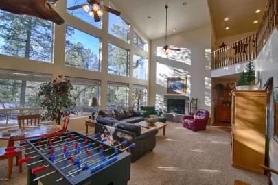

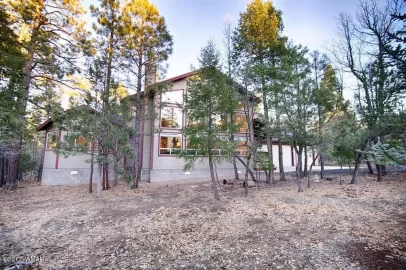

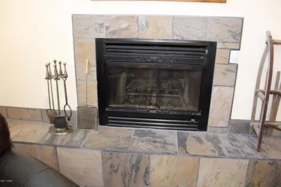

Load a pic or two of the current arrangement for the pro's to review. Maybe a pic or two of the entire place. For those of us who dream of mountain living. But live in a real enchanting. Cornfield............
Thanks for the replies. The stoves I researched were chosen based on heating capacity for the size of the home. There are two ceiling fans installed in the room as can be seen in the photo. The chimney is not made of brick, it's framed in with rest of the house. The photo isn't great, but you can get the idea on the exterior construction. Based on the size of the stove, it looks like it might be best to put it out farther into the room and tie into the chimney above. Is that going to hinder performance at all?
I really appreciate your guys' advice on what you would recommend if you were in my place. Like I said originally, my ultimate goal is to do the best I can to heat the place with a wood stove, however that works out. Thanks again in advance for your help!

Ah, a picture is worth a thousand words. That is a zero clearance fireplace. Tapping into the chimney higher up is not an option. The most likely options are to replace it with a good EPA ZC fireplace or remove the hearth and put a large, rear-vent wood stove on a new hearth at floor level or install a freestanding wood stove at another location, maybe at the wall on the opposite side of the room?
What is the height at the top of the ZC fireplace opening when the doors are open?
if your want a freestanding Blaze king you have some option. you could demo out the ledge and current insert and just have the freestand just sit in front. or you can put it in the corner of that wall where the windows are. i mean your are the best eyes as far as where the pipe is and what looks best and what is the place sometimes those 2 dont work together. you also have carpet which might suck cause of dirt and bringing in the wood. If you think a little ahead it will be sweat setup as the king def has some long burn times.

And with that fireplace your options are very limited the best solution is to remove it and build an alcove with a new chimney. The minimum required would be a freestander in front with a full liner in the chimney. But you need a full inspection of the system to check for condition and to make sure it was installed correctly to begin with

It is not an insert it is a zeroclearance fireplace they are very different. Yes I guess you could do what you described but it is a pretty half assed way to go about it. I would much rather see an alcove install myself.
With the current hearth removed and a stainless liner there are some large non-cat stoves with rear-vent that could work. In non-cat the Jotul F600, Quadrafire Explorer III and the Hearthstone Manchester and for cat stoves the Ideal Steel or Progress Hybrid stoves by Woodstock could also work.

From the top of the fireplace to the ground (below the hearth) is 50 in. Fireplace width is 43 in. Obviously that's going to inadequate for any top venting stove. So it appears my options are (1) tear out, make an alcove, redo the chimney with proper venting, insulation, etc up to code or (2) seal off the current set up and install in front of it with free standing, with a standard black pipe straight up through the roof.
If I go with option 1, is it possible to tear out the lower section of the chimney to make enough space for a top vent?
I also read that with ZC fireplaces that the entire construction isn't made for the heat that a freestanding puts out (I think it was UL 103HT rated), so you really have to start from scratch. Is that an accurate assumption?
