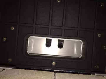

just a quick tip, if you want to reduce the primary air and the restrictor plate was shipped in your unit or added, you can slide the plate up a little and retighten the two bolts. Kc regency dealer

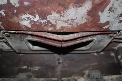

It's been a while since I checked in, and it's been an interesting season with this insert. I've had problems with the install (insulation issues), and had an insert that didn't originally have the restrictor plate so it burned faster and hotter than it should have. Long story short, I just had a new liner, new insulation, and a new insert installed and I have a question.
I think back on page 14 or 15 or so there was talk about the bypass and how it works. I'm looking at my new insert and just want to make sure everything is okay before I do the break-in burn. Pushing the bypass rod in seems to successfully close the bypass. Pulling the rod out seems to pull the main bypass plate back but leaves a lighter plate in place. I can reach in and feel that the plate that doesn't get pulled back is just loose, and there's a lip on it that will push it closed when the main bypass is pushed closed, but it doesn't get pulled open. The three photos I'll attach here show the view from inside the firebox with the bypass closed, with it opened by the rod, and with that "loose" plate manually pushed back by me sticking my hand up in it.
I'm guessing it's probably correct and fine, but wanted to ask the collective first. I hadn't noticed this with my old stove, but to be honest, I hadn't looked.

If folks are reading this thread and are on the fence about this insert, I'm told that regency has started making them within the last month or so with some improvements incorporated into the design. They've been including the restrictor plate for a while now, but there was also a "fix" to the bypass plate (or somewhere in the vicinity of the bypass plate) to address an issue some customers had where the bypass didn't close properly. I didn't have that issue, but it certainly sounds like others have. I also noticed that the plate in the top of the firebox seems more robust (see the photos in my previous post). I'm not sure about any other changes, and not having even done the break-in burns with my new stove I can't speak for how it'll be. FWIW, after my restrictor plate was installed in my old insert I was getting pretty good burn times (12+ hours, sometimes even 14+) but by the time I got it the damage from overfiring was done.

So that lighter gauge steel piece is your upper shield. When installed correctly (this is based on the pre-improved inserts that you mention in your next post, please verify with your manual) this plate should be centered between two verticle pins from front to back. The upper shield actually "surrounds" the bypass plate on the top and sides (hope that makes sense). Looking at my manual, it shows the proper installation on page #11. My upper shield can be moved by hand as well, but it stays in place when I open/close the bypass. Hope that helps.
Matt

Glad to hear you've got your installation dialed-in. It was mentioned somewhere previously that the add-on restrictor plate for the primary "boost" air inlet in the front-middle of the stove can be adjusted. While doing my end-of-season cleaning I took a close look at this. Indeed, the restrictor plate has two tabs on the sides. One can loosen the two bolts holding the restrictor plate in place and you can raise it up or lower it down. The hole in the restrictor plate is about the size of a pencil eraser and it covers the nickel-size opening in the primary air manifold. By raising it up you can reduce the size of the opening to a pinhole, or close it off completely. This is actually quite a lot of adjustability. I reduced mine to about a 2mm opening so we'll see what happens next season. But this is definitely something people can experiment with, if you're into that sort of thing. Also there is stamped-steel nozzle that covers the opening which is probably intended to evenly distribute the incoming air across the width of the primary combustion zone. This nozzle has some adjustability right and left so those of you noting one side of your fire burns more than the other can experiment with moving it slightly off-center. Depending on your draft, you could make the opening bigger or smaller and adjust the nozzle right or left.

Thanks for the tip on adjusting plate up or down. Can't wait till the next burn season to start testing.

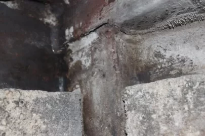

We purchased this unit last October and upon cleaning it recently I discovered damage to the unit, specifically the catalytic converter, the plate around the bypass opening and the two welds located towards the top in back of the unit on both sides. I have posted pictures of the damage. I am very concerned as we operated the unit per the directions in the manual and we have an interior temperature probe which allowed us to accurately monitor the temperature. I saw a previous post of someone who also experienced similar damage. Just wondering if anyone else experienced this and what was the outcome? Any comments are welcomed.

We purchased this unit last October and upon cleaning it recently I discovered damage to the unit, specifically the catalytic converter, the plate around the bypass opening and the two welds located towards the top in back of the unit on both sides. I have posted pictures of the damage. I am very concerned as we operated the unit per the directions in the manual and we have an interior temperature probe which allowed us to accurately monitor the temperature. I saw a previous post of someone who also experienced similar damage. Just wondering if anyone else experienced this and what was the outcome? I have yet to call the company that installed the unit as we had a very poor experience with them. Any comments are welcomed.

I had the same exact same thing happen to my unit with the cat crumbled away and the plate around the bypass sagged and cracked. Looked identical to your pics. Contacted the place I bought it from and they were able to replace the whole unit free of charge through regency. Definitely go for the same thing. Your unit is one of the older ones like mine was. There has been several changes to the unit to beef it up and get it to run more efficient instead of firing with an inferno inside the firebox. Had my replacement unit installed this past week and am excited for the cool weather to come to try her out. Do yourself the favor by getting on that sooner than later before the fireplace companies get slammed with cleanings and installs in the fall.

Can you please post pictures of the inside of your new stove? Would love to see what changes they made. I have a hair line crack on two of the welding areas, but the stove worked great all winter. So not sure if I should ask for it to be replaced.
