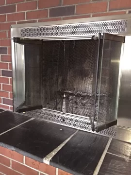

Fireplace measurements:
37''(w)
25''(h)
26''(d)
At 18''(d) 21''(rw)
Recently got with a local installer regarding our open fireplace on the first floor of our home. Asked them to come by and give us a quote, and what they thought of the setup.
Quote:
[Hearth.com] Advice & Suggestions
He said due to the size we'd be limited to either a wood or pellet insert.

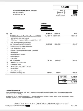

Installing company sent me another quote, with a different insert. I'm not too sure about model differences at this point, or what even to look for. But, while I do some more research and start to learn, I would love to know what people think about the models they selected and provide any additional information:
(broken link removed to http://www.woodheat.com/products/fireplace-inserts/wood-inserts/jotul-c-450-kennebec.html) ($3,039)
33 Elite Plus Arch ($3,618)

The taper is important and will help determine what fits and what doesn't. The 33 Elite fit in my fireplace as did the Osburn Matrix, which I ended up purchasing and was very happy with.
The other thing to consider is that it's probably okay if the insert doesn't go all the way back against the back wall of the fireplace, and sticks out onto the hearth a bit. In that case you might just need a hearth pad or something non combustible in front of it. But exact clearances will depend on the stove.
Grab a tape measure and take a few pics of it in the fireplace opening, showing the taper. Mine was also tapered and a very close fit based on measurements, so I made a scale model before I ordered it. I used some cardboard boxes to make a box that was the same size as the stove and then stuck it in there to see if it would fit.
I was informed, due to the regulations in our area we'll have to get a small extension added to our hearth.
