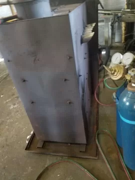

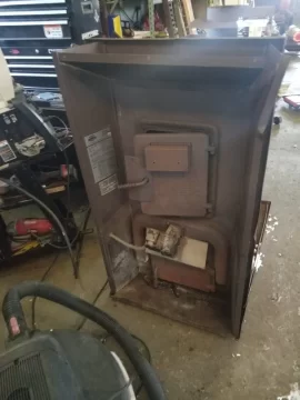

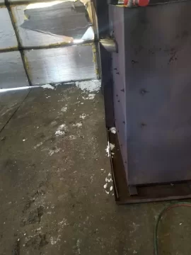

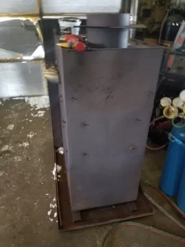

Mine is similar to the one in the picture but has no intake on the back like that one. I can't find anywhere it pulls air into the fire ox but the door. I have some pictures on my phone from when I was working on it. I'l post them to show you.

It looks like the lower door has a forced draft fan for a thermostat, and there's an intake in the upper door? That thing looks like a dinosaur! I'm sure it heats well, but looks like it's hungry.
It is the old one out of my house. It was put in the house in the early 90's. Heats very well but ever since I put it in my garage it seems like it could use more air. The draft fan works but does not seem to have much effect. The opening on the door is so small and there is no way to leave it open. I have just been leaving the ash pan door open when I run it. I figured maybe someone on here new something I was missing.
