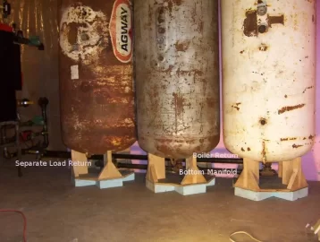

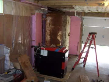

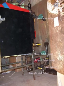

Can't find a thread just now, I suppose here's as good a place as any.
I used a manifold top and bottom with separate boiler and load connections teed into the manifolds in 'reverse-return' configuration. Having separate connections to the manifolds for boiler and load seems pointless to me now. Neither do I think it was necessary to tap into the manifolds at those points between the tanks.
I think I could have simply gone straight into the left end of the bottom manifold for both boiler return and load return teed together, and then could have gone down to a U-turn on the right end of the top manifold for reverse-return purposes.
Since then I've seen the dip tube/riser tube idea using side ports and I think that could be a lot easier and would perform quite well, although in my particular situation with the tank and boiler positioning, having a straight-shot from the middle of the tanks to the back of the boiler worked out nicely.
