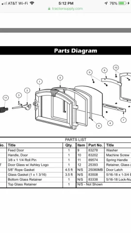

I have that named stove and was wondering if i am doing anything wrong...

Is there a gap on the bottom of the glass where the gasket is missing? There should be, that is the air wash.

Air gap? Seal missing? Hmmm...havent looked/seen anything...
Will check at home...
Soooo...
Just looked some more intense the other day...
The front glass is all way round well sealed by metal pressed stove seal fabric...this cord looking stuff...
Any idea?
Number 6 is your door glass gasket. The very bottom of the gasket is missing by design that is your air wash
[Hearth.com] Air wash glass on King Deluxe Pellet Stove, KP130/5502
Thx for looking that up...is it is supposed to be missing, that i had a very busy assembler on my stove, cause the bottom part is also roped...
I have a solid surrounding of the glass...maybe thats my issue...
Will dig some into that...
THX!!!
