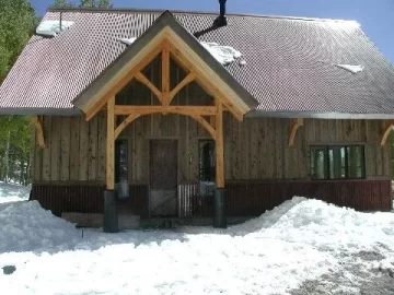

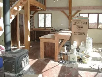

I need to heat this space on weekends. It has an open floorplan, a 30 foot ceiling, is located at 10,000 feet with a large ceiling fan. I've already posted a thread regarding the upcoming equinox, however, my wife only likes the more traditional cast iron appearing stoves. I also need to get this installed within the next 2 weeks, so the equinox is out. I currently have a 2005 jotul 500 oslo which will not adequately heat the space on available aspen and pine. It is rated at 70,000 btu's, states it can heat up to 2k sq feet, weighs 445 pounds and has no listing of the actual firebox volume. In any event, I've narrowed my choices to the pacific energy t6 alderlea, the quadrafire isle royale and the vc defiant nc. The defiant has the largest firebox at 3.4 cu feet vs 3.0 with the t6 and isle. The t6 has a greater mass at 585 vs. 480 for the isle and 510 for the defiant. The hardest thing to understand for me is the btu ratings. The t6 is the only stove with btu ratings greater than my current stove at up to 95k. The isle is rated up to 65k and the defiant to 60k. The suggested square footage is 2k to 3k with the t6, 2400 with the defiant and 2500 with the isle royale. I'm leaning towards the alderlea based upon btu and mass but like the top load of the isle and the looks of the defiant. I don't want to replace my current stove with a stove which won't do the job. Please help.

I don't know how to break this easily to you Ken, but this is an energy disaster. Lovely home, but not designed for easy wood heat. I suggested the big Blaze King, but it sounds like your SO nixed that idea. Too bad, you will need all the heat you can get, especially considering this is a temporary dwelling. It takes time for heat to equalize in a house, often a day or two in the dead of winter. You are asking for instant relief to which I don't think there is a magic solution short of a large quantity of fossil fuels being expended.
The alternative might be a wood furnace if there is a basement. But nothing short of brute btus is going to make this place comfortable in short order.
My God! That stove pipe is unbelievable.

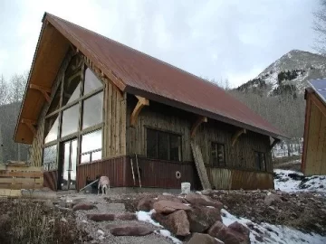

I've got r32 in the roof, r 16 in the walls, modern double pane glass. VERY efficient envelope. It is directly south facing and today I was up on the mountain and outside air temp was 28, inside at 4pm it was 65 without any heat source. I have a direct vent propane wall heater which keeps the place at 45 degrees minimum throughout the winter. My current stove, if burning at maximum, will heat the space. However, I'm reloading every 2 hours. In response to Be Green, energy disaster might be a bit harsh. Last year while unoccupied, I kept the place at a minumum of 45 degrees from November to May at 10,000 feet with a propane wall stove and consumed a total of 400 gallons of propane which also ran a generator on the weekends, hot water heater throughout the winter and cookstove.

The house is getting killed by the huge glass area. Yes, you get good gain during the day, and that is commendable, but even with modern double pane it is a large heat radiator at night. Perhaps you can contrive some sort of insulated panels or insulated curtains to mitigate the nighttime loss.

Thanks for all the input. After reading the above input, I realize that the reason I struggle to heat my space is my inability to load the jotul effectively and I have soft wood which hasn't been seasoned well. I usually can get 3 splits of wood per load. I try to make these on the bigger side thinking they would heat longer than more small splits. The front loading feature of the jotul is tough because the ash spills out and the logs roll out if loaded with more than 3 splits or logs. The side load is roomy but it's precarious to "shove" a decent sized log above the wood below without pushing the towards the front glass. I still can't find the firebox volume of the oslo and the epa rating is 12-35 k/hr. I have numbers from 1500 to 2000 sq feet for heating capacity. I'll give jotul a call and find out the actual firebox volume, of which I'm certainly not using effectively. Of note is the fact that I have a propane direct vent wall heater in the same room which is rated at 50k/hr but is significantly derated with altitude. It has an attached blower and can heat the room. I'd much rather use wood than propane.
That is one of the advantages that the Defiant or other top load stoves will offer, you can probably get more wood into a top loader with a given firebox size than a front or side loader, the stove has a couple of andirons in the front to protect the glass, which actually make it hard to front load, but you can essentially open the top and stack wood in as full as you can get it. No worries about stuff rolling out on you.
You might be able to get better use out of your Jotul if you can load it "north-south" instead of "east-west". (I.E. with the ends of the logs going front - back) I don't know if the shape of the firebox allows this. The advantage of N-S loading is that if the splits want to roll, it is toward the sides of the stove rather than the front, so you can stack more wood into it if you need to. The folks with squarish fireboxes like the PE's swear by this, but it depends on the stove design whether it would work for you or not, and I don't know your stove well enough to comment either way.

Although this place may have the volume of a 2800 sq ft house, it has the glass area of a 5000 sq ft house. I'll have to check, but I believe this amount of glass area would be in violation of WA state energy code (much milder climate), without triple or quad paned windows. The only solution I see is better glass insulation, reduce the volume of space being heated or more, steady btus.

The Oslo firebox is 13" deep from where the air inlet is on the front, 15" to the glass. 24" wide and 12" high.
I would say about 2 cubic feet.
