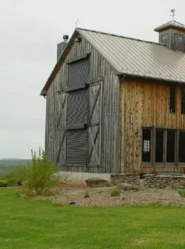

It sounds like you may be best off fitting roller shutters to reduce heat loss from that south facade. Here is a link to one of the companies (there are many) that sell this kind of product. You can reduce the heat loss by half which is pretty significant.
(broken link removed to http://www.rollupshutter.com/products/outsideviews/index.asp)

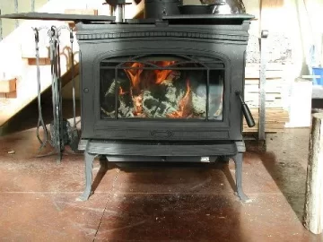

I was communicating with Be Green who compelled me to write a follow up to this thread. I purchased a PE alderlea T6 and installed it in November. It's been around 0 to 10 degrees this winter with the largest snow year in the past 8 years. The new stove when compared to the jotul oslo 500 has been an impressive increase in wood capacity due to north south loading (I'd say at least double the real world wood capacity) , all night burns are now possible (8 hours) and it lights and takes off like a rocket ship. The loading is much more convenient due to the large front door. The heat is largely convection with the cast iron cladding remaining relatively cool and the front glass putting off a great deal of radiant heat. The drawback when compared to the jotul oslo would be inferior casting detail, less substantial ash tray and damper handle and the possibility of getting a hernia when moving a 600 pound stove.

It's not that common for us to get this kind of comparative operation in a tough to heat situation. I must admit I was skeptical (and wrong) about the stove making such a difference. I thought the large glass area would ultimately be the issue. The fact that the T6 is now covering their needs, without blower is very impressive.
I believe the major difference is as Kenkathy said the N/S loading.
